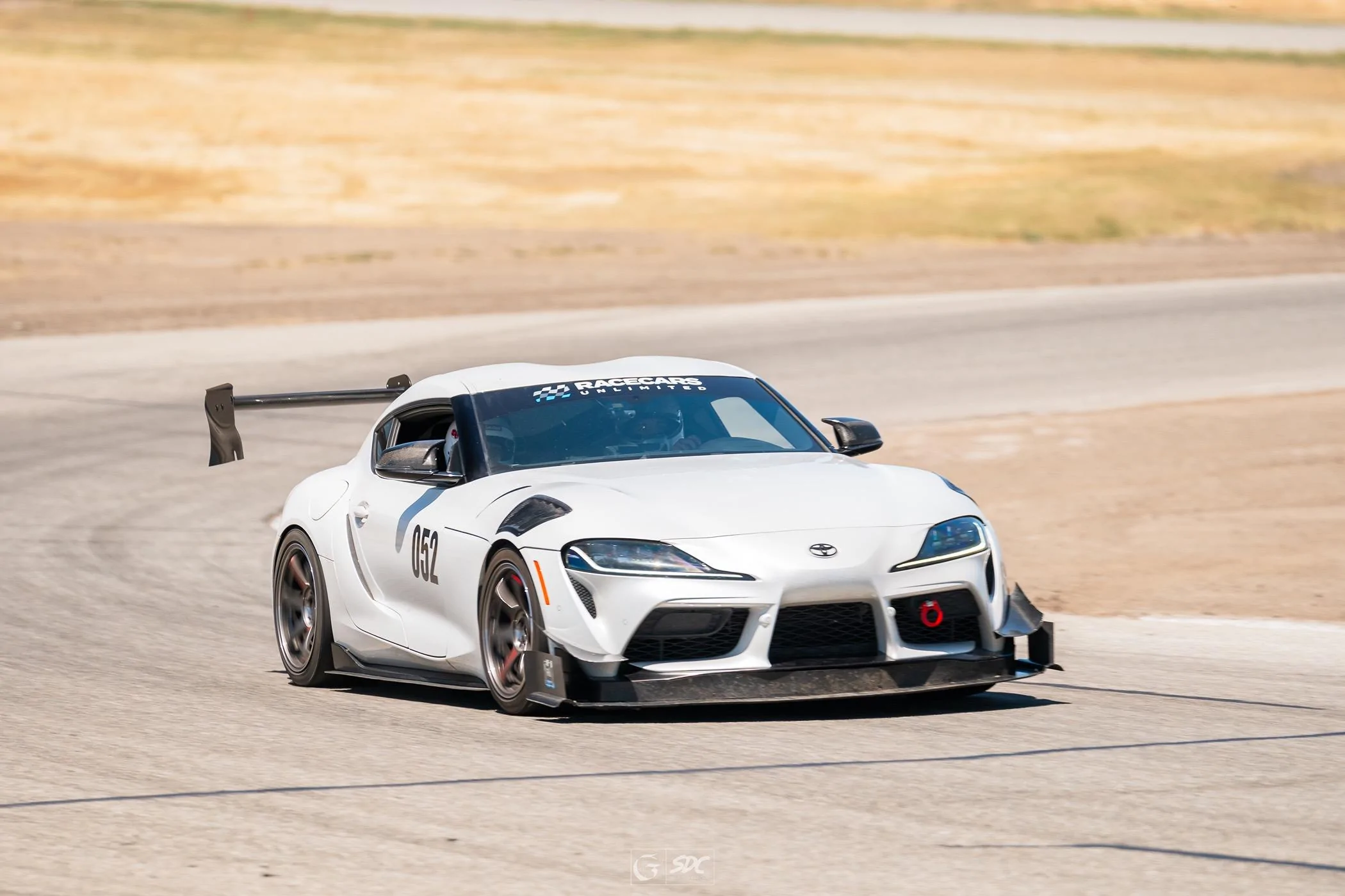

The adro wing has been great for me and I think with the new height it is even better. Here you can see what it looks like with color match at Watkins Glen.
Do you have rear view pics? Curious to see how the taller version sits versus the original

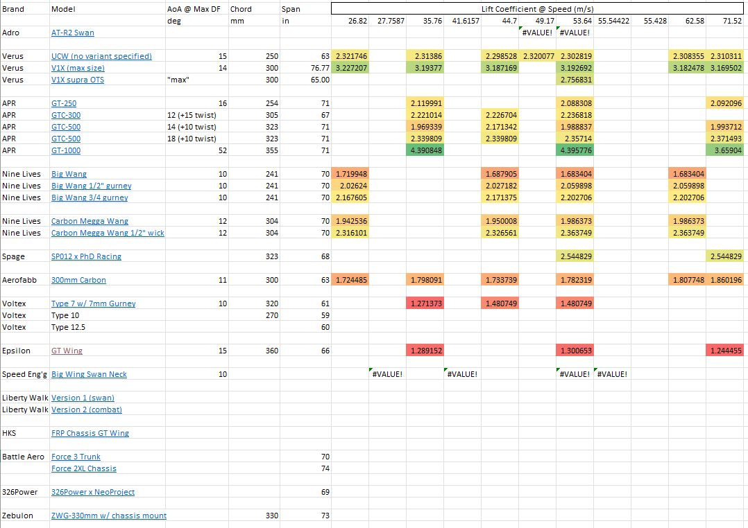

maybe you could provide chord and length measurements? if the area is huge enough, even an "okay" airfoil will make a ton of downforce.
73" - 1854mm. Creates a ton of downforce, ive gone faster in most high speed sections than before at my home track by roughly 10 mph at 0 AOA, enough that my front end isnt balanced anymore. Although its on the pricier side up there with spage. OTD was about 4.2k + 250 for chassis mounting.

73" - 1854mm.
330mm x 73 inch puts the zebulon about 5% larger in size than the V1X. It looks like the v1x is also currently top dawg when it comes to lift coefficient, though this looks suspiciously high. the good-ol' Selig S1223 airfoil maxes out at ~2.4 lift coefficient and the other wings are coming in right at those numbers (as expected). Maybe my math is wrong, but the other (good) wings in the table are all clustered around the same value. ?‍♂ ?‍♂ ?‍♂
It's kind of irritating that so many vendors are asking $1000+ for their wings and won't even tell you basic things like the wing's dimensions.
