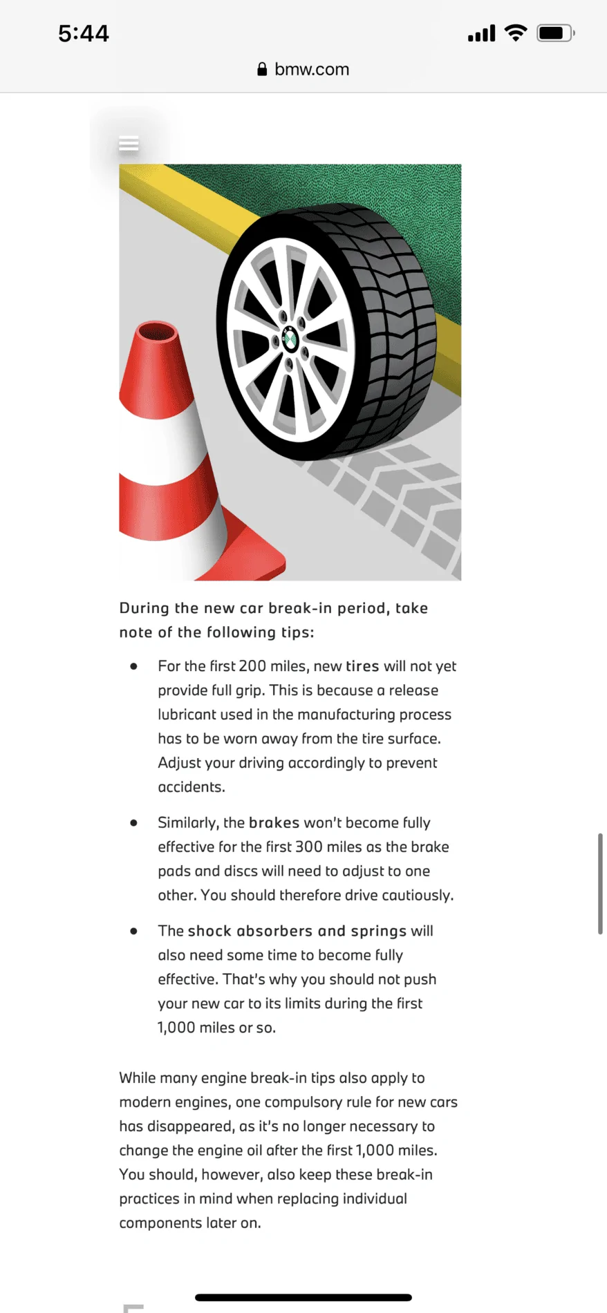

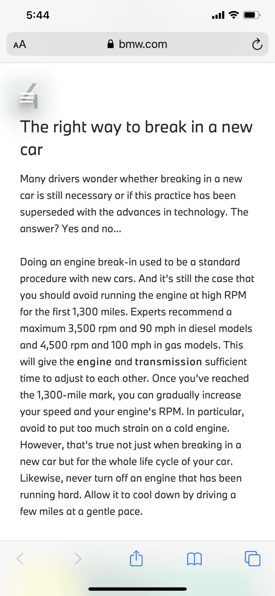

Changing the oil early for the first time os a very old school practice. I wont knock it I understand some of you are set in the way. But for those curious this is straight from bmw.
Read #4. It’s obviously up to the owner of their vehicle how they want to do their changes but id there is someone that is worried they missed that opportunity -no your car isnt going to be permanently damaged because of it.
https://www.bmw.com/en/automotive-life/break-in-a-new-car.html
Informative, thanks
