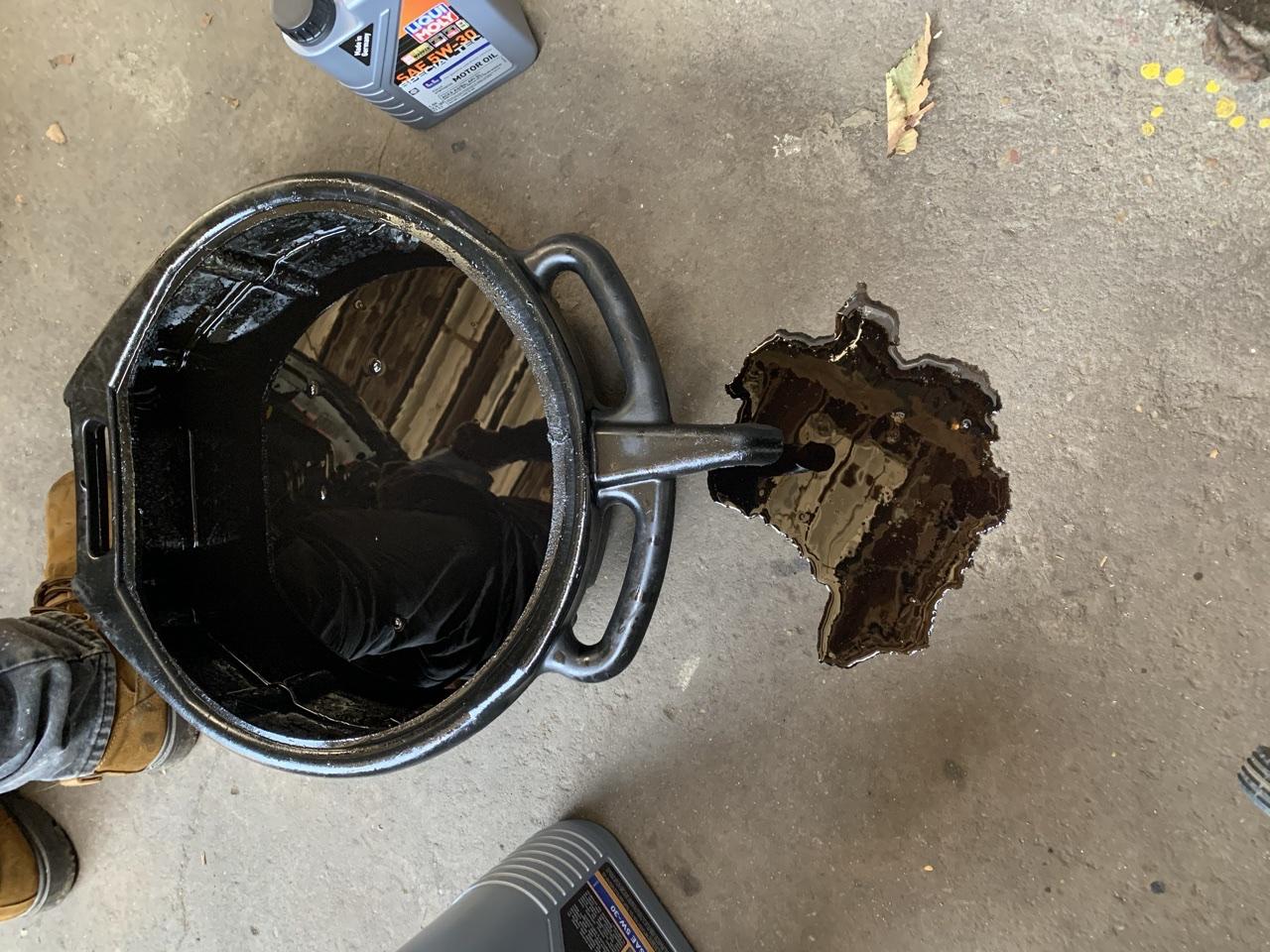

Pics of oil at 2500 miles which included 3 track days

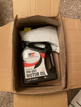

GR Supra oil came in finally!!
