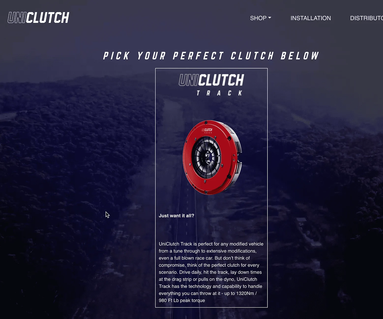

I did see that UniClutch has the clutch released on their site. I only have 1500m on my 2024 but am running more that stock power. For the money and it being a twin i might try this out.

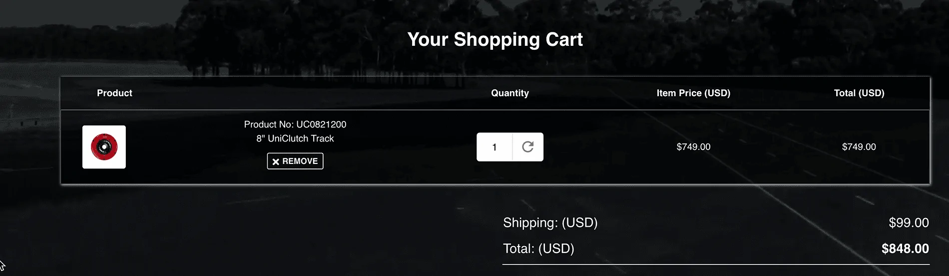

I just placed an order on the Uni Clutch, which is pretty much the same price, works with stock flywheel, and has the same pedal feel as stock.
