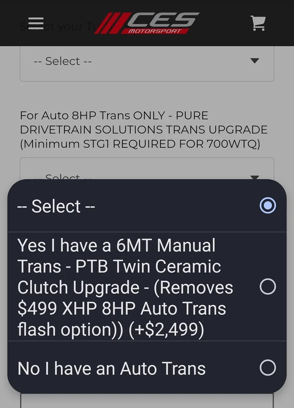

Given that the drivetrain is essentially BMW, I think it is best to determine what is working well for other B58 powered cars, of which there are quite a few, and determine what makes the Supra any different from them in terms of clutch fitment.
It seems that application to the Supra isnt on their radar, or an afterthought amongst some clutch manufacturers.
I've also been looking for evidence of what works for the MT S58 BMW M cars since they make quite a bit of torque and power too.
That said I reached out to a few more folks, here is the latest. Basically, development is in work.
Would be nice to get some tuner shops who test and tune these cars to chime in but seems like its up to us to step up and see what works.
Xclutch
https://www.xclutchusa.com/
-Got email confirmation they are working on it for the Supra, will announce on social media when available.
DKM
https://www.dkmclutch.com/
-Working on other B58 BMWs, they need a test Supra (someone should volunteer, they emailed me asking if I wanted to)
-I emailed 22rpd (BMW shop in Seattle, WA area) and they claim these work well in high hp cars:
https://22rpd.com/shop/product/107
PTB
https://www.ptb-shop.de/?cPath=97_103_237&cat=c237_B5830A-b5830a.html&language=en
-Email response to me confirms products for B58 but I'm not absolutely sure on Supra fitment
-New product is CNC dual mass flywheel, twin disc setup
-CES Motorsport emailed me, says they work well in G80 cars and they list it as a clutch option on their 700+ hp supra build package
