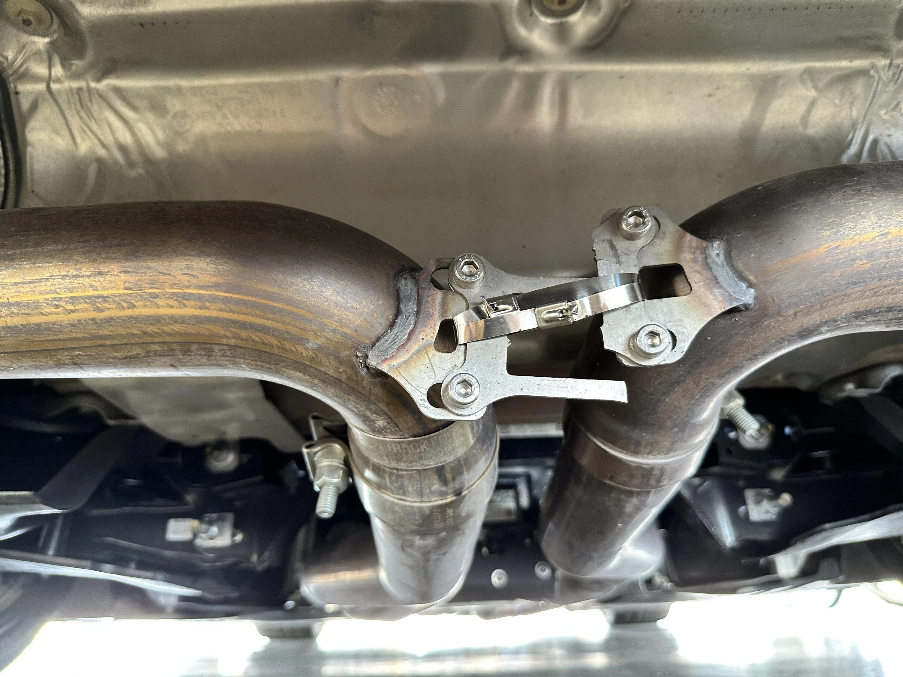

Anyone removed the flimsy undercar brace?

The bar is there to add rigidity and stability to the chassis when that area is under tension and stress.
It is not supposed to be very rigid because it has to be able to flex the way the chassis does.
You don't feel it because you don't drive the car hard enough. Even on a drag strip these bars improve traction by minimising chassis twisting at launch and full throttling.

That bar adds structural rigidity to the unibody, it is functional and should be left installed. It may seem somewhat flimsy when not installed in the car and so do most of the other stamped components that make up the vehicle structure until they are all welded, glued or bolted in place.
As an engineer who spent several years working in the aviation industry early in my career I analyzed that component when I installed my exhaust and it is structural.
Even the large aluminum plate under the engine is structural. If it was not needed Toyota/BMW would have not engineered it into the vehicle.

I expect it's plenty strong under lateral compression and tension.
This obviously doesn't matter to folks who only drive in a straight line.
And nothing aside from driving in a straight line matters. It’s a win win.

I have mine off It does pretty much nothing. I had to remove it for my aftermarket exhaust.

You can buy it almost anywhere, this is what it looks like:
https://www.a90shop.com/product-page/cusco-rear-chassis-powerbrace-supra
It fits just fine with my HKS Super Turbo exhaust

And my AWE exhaust, to specifically answer that part.
And with the Magnaflow, any properly designed and engineered exhaust should fit fine with the brace in place…
