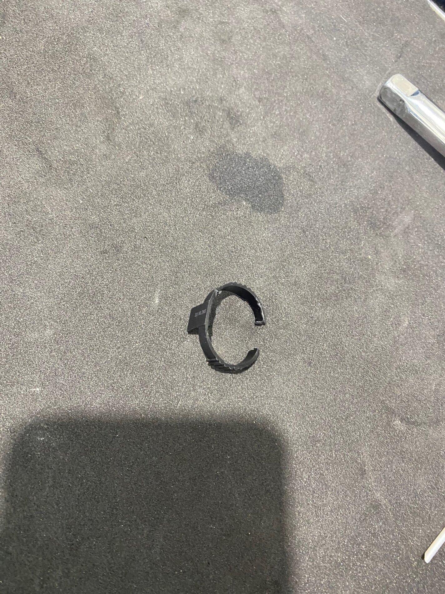

Any one got a link where I can buy a replacement clip? I broke mine trying to take it off ?

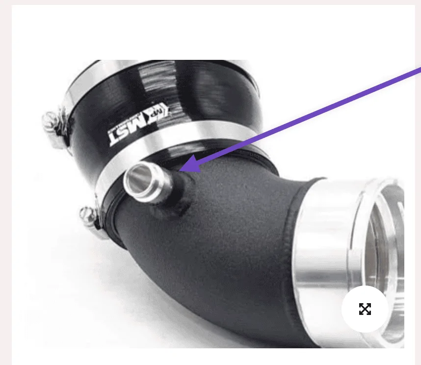

When installing the MST v2 intake pipe, I broke about half of the incredibly fragile clip that holds the breather hose into place into the bottom intake pipe. The tube still seats properly into the intake and appears to be mostly sealed. It also looks like it's a bitch to replace the entire hose.
Do I just need to bite the bullet, remove everything, and replace this hose?
Yes, it will be best to get a new one ☝

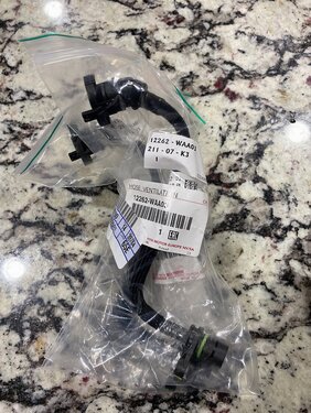

Have to replace the whole hose. I got my local toyota dealer to order one in and install it for me. I ordered an extra one too because I know Im gonna break it when I go to install my chargepipe

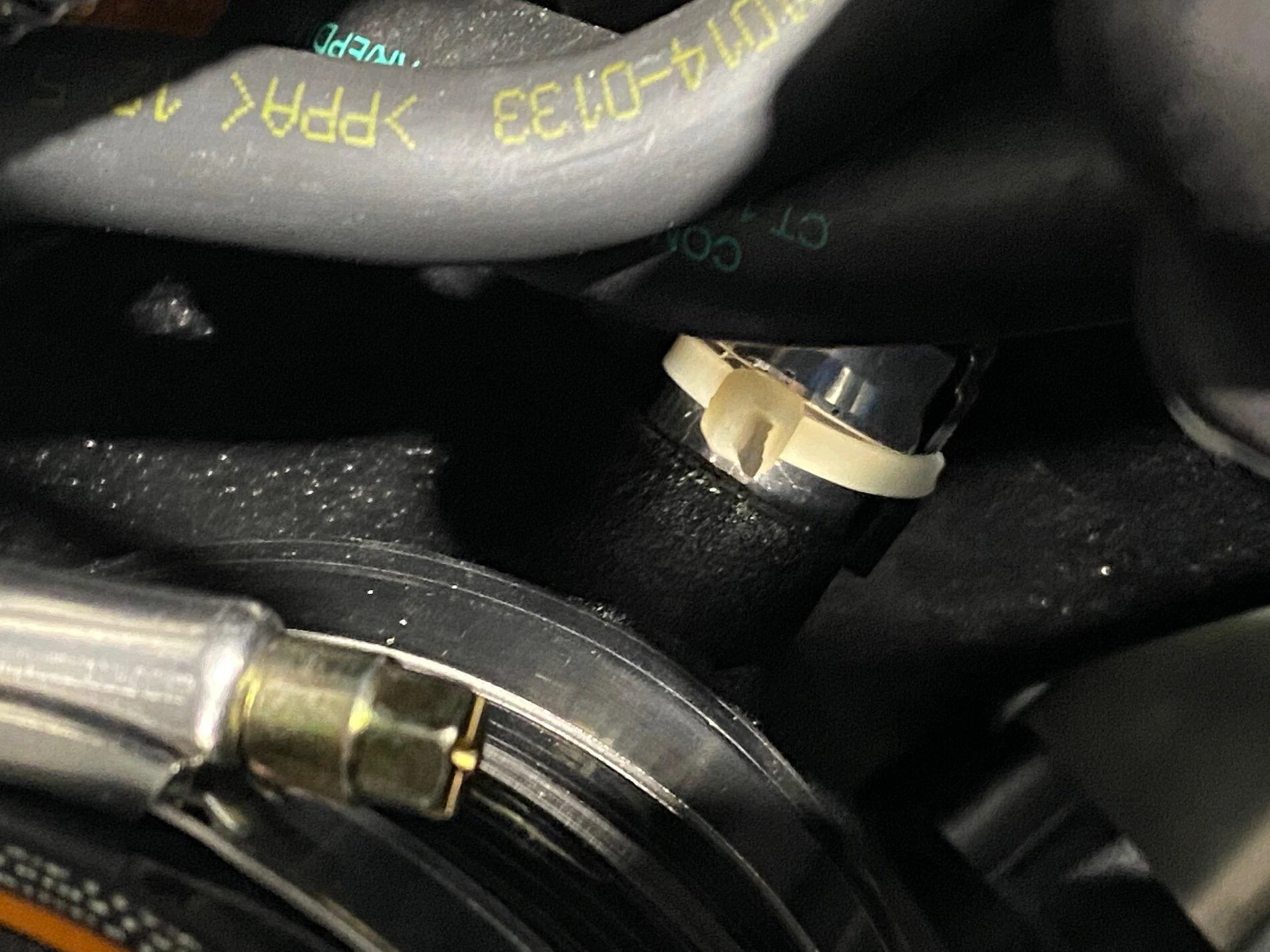

There's an orange O-ring in the turbo inlet pipe I transferred over that helps with the seal. This is assuming you got the V2 that replaces the full assembly all the way down to the turbo. Hopefully you can see it in both videos.
how do I know if I broke the breather hose? It seems looser than when I started but I don't see anything broken but its pretty hard to see on the engine side of things
