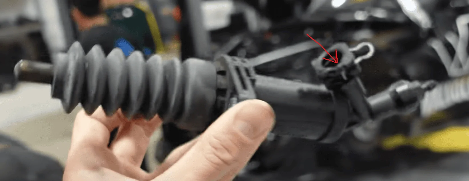

Just had my Clutch Delay Valve removed by @Speed Logic
Immediate thoughts, things felt a lot smoother, especially between 1-2. I didn't get to really get on it but I'll be doing some driving this weekend.
Currently at 770ish miles. Whatever is causing this premature slipping must be material related or mechanical somewhere else. I don't think this mod is the solution but hope it helps in the long run.
I definitely want to hear more about this and what the process was of removing it!
None of us are as delusional to think it's the magic fix, but we're certainly hoping for improvement. Was it in the line or the slave cylinder?
Thanks for the shoutout @Eastwood ! We have been removing these CDV from BMW vehicles for well over 10+ years now with good results. They don't usually affect clutch wear/tear but usually allows you to do a much harder (read regular MT) 1-2 shift if doing a power shift or hard shift without much trouble. Without the CDV removed it will cause issues on a hard 1-2 shift - a delay and sometimes difficult to slam it into the 2nd gear. There is plenty of info on this issues with regard to BMWs. If you anybody wants to do reading from a good source without conjecture:
https://www.zeckhausen.com/catalog/index.php?cPath=6562
There are threads on this forum if you want to reference it. But the below attached picture someone posted is where its located - and it has to be removed from inside the Slave Cylinder. After removal you will need to properly bleed the Clutch Slave cylinder so there is no air in the line.
Not condoning TJ Hunt videos or his advice, but i just watched his video, and he replaced the slave cylinder. The valve looked like it was in here
For those who like to DIY things, is doing the wood screw method still an option for the supra's slave cylinder or are there any more appropriate tools needed?
Wood screw works perfectly fine if correct size/width. There was no special tools used for that portion on my end to be clear. Hope all goes smoothly!
