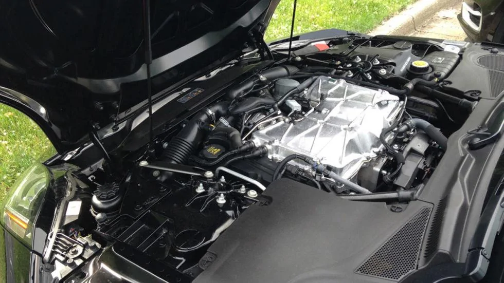

It's also incredibly easy to build a V6 from an existing V8. Jaguar, for example, doesn't even bother changing the outside dimensions of its block. The company's V6, available in every new Jag sold in the U.S., is simply its V8 with shorter cylinder heads and balancing weights on the crankshaft where the last two piston throws should be.
It works, but not without compromises. Like all V8-derived V6s, Jaguar's has a 90-degree angle between its cylinder banks. That works well for a V8, but it's the wrong angle for a six, because it means the engine will fire at uneven intervals, and odd-fire engines run rough and make terrible noises. A V6 will fire at perfectly spaced intervals (read: smoothly) with its banks splayed to 120 degrees, but that's too wide to fit in most cars. Halving that angle keeps the even firing order and, with a couple of crank counterweights, it allows for smooth running. Toyota's ubiquitous 3.5-liter V-6 is a 60, and it's as creamy as they come.
But a 60-degree six negates the economic advantage of basing the engine off an existing V8. So luxury brands tend to stick with the 90-degree architecture and apply various tricks to make it work for a V6. The big one is using split, offset crankpins. These are impossible to fully understand without a physics degree and a stiff drink, but in essence, they slightly offset opposing pistons, forcing them to move in such a way that the engine fires evenly. But these are difficult to engineer and expensive to manufacture. Plus, the 90-degree V6 usually has an engine-driven balance shaft to prevent the whole complicated mess from vibrating itself apart. All of this adds expense, hurts efficiency, and requires royalty payments to Rube Goldberg.

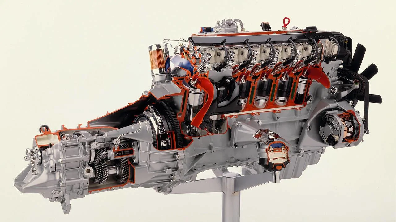

You can avoid the drama by arranging the pistons in one line. A straight-six doesn't need split crankpins, balance shafts, or big counterweights, because each of its cylinders has a twin that's doing the opposite thing, at the same time and in the same plane, canceling out the other's forces. That lack of internal dissonance gives the same perfect balance as a V12. There's a reason museum-piece marques like Rolls-Royce, Mercedes-Benz, Jaguar, Aston Martin, and Alfa Romeo earned their reputations with inline-sixes.
At the moment, BMW remains the sole champion of the straight-six. Munich engineers admit that they regularly develop and test prototype V6s, per internal policy, but say the results don't come close to meeting company noise and harshness standards. Mercedes-Benz must not have such stringent benchmarks. Once renowned for its silken inline-sixes, Stuttgart phased out those engines and began building V6s out of its V8s during the dark, cost-cutting days of the marque's DaimlerChrysler ownership. As the sting of that failed merger continues to fade, so will the company's coarse, complex, 90-degree V6, which is being retired in favor of a 60-degree unit. This stopgap engine, which fits into the vee-focused packaging of Mercedes's current lineup, is noticeably smoother than the 90-degree unit, but its exhaust still sounds like Fran Drescher on Spanish fly—not the voice you want your luxury car to sing with.
