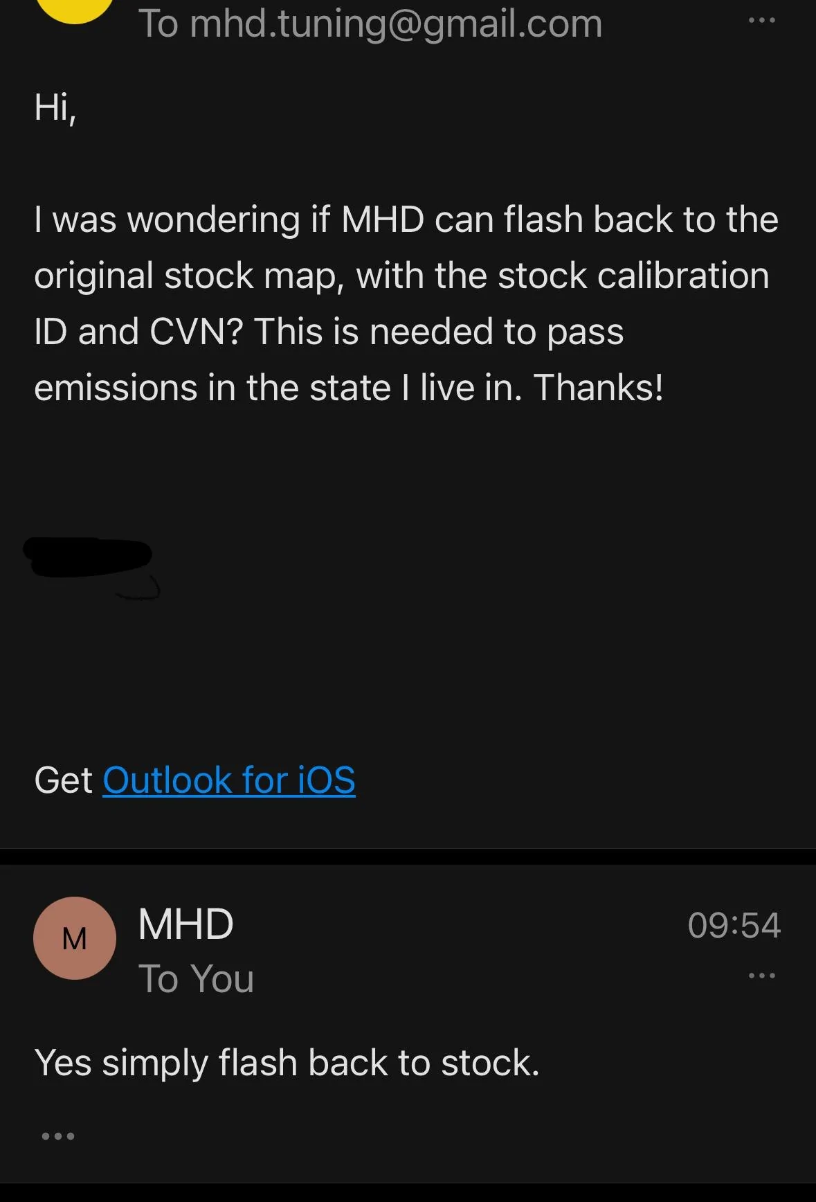

Do you know if BM3 or MHD will retain the calibration ID and CVN on their stock maps?
Unfortunately they will not - usually Stock flash or Stage 0 has a different CalID and Checksum than your original stock untouched ROM.

If you remove the tune fully and go back to Stock file it will retain original Checksum and CalID. My apologies only Stage 0 won't pass smog - but if you fully remove the tune back to Stock you'll be fine without issues to pass smog.
This applies to both Bootmod3 and MHD.
Pretty much for smog you'll want to remove the Downpipe and put your tune to Stock to be able to pass. Just don't leave the tune installed in a Stage 0 option. Sorry for any confusion on prior post.
