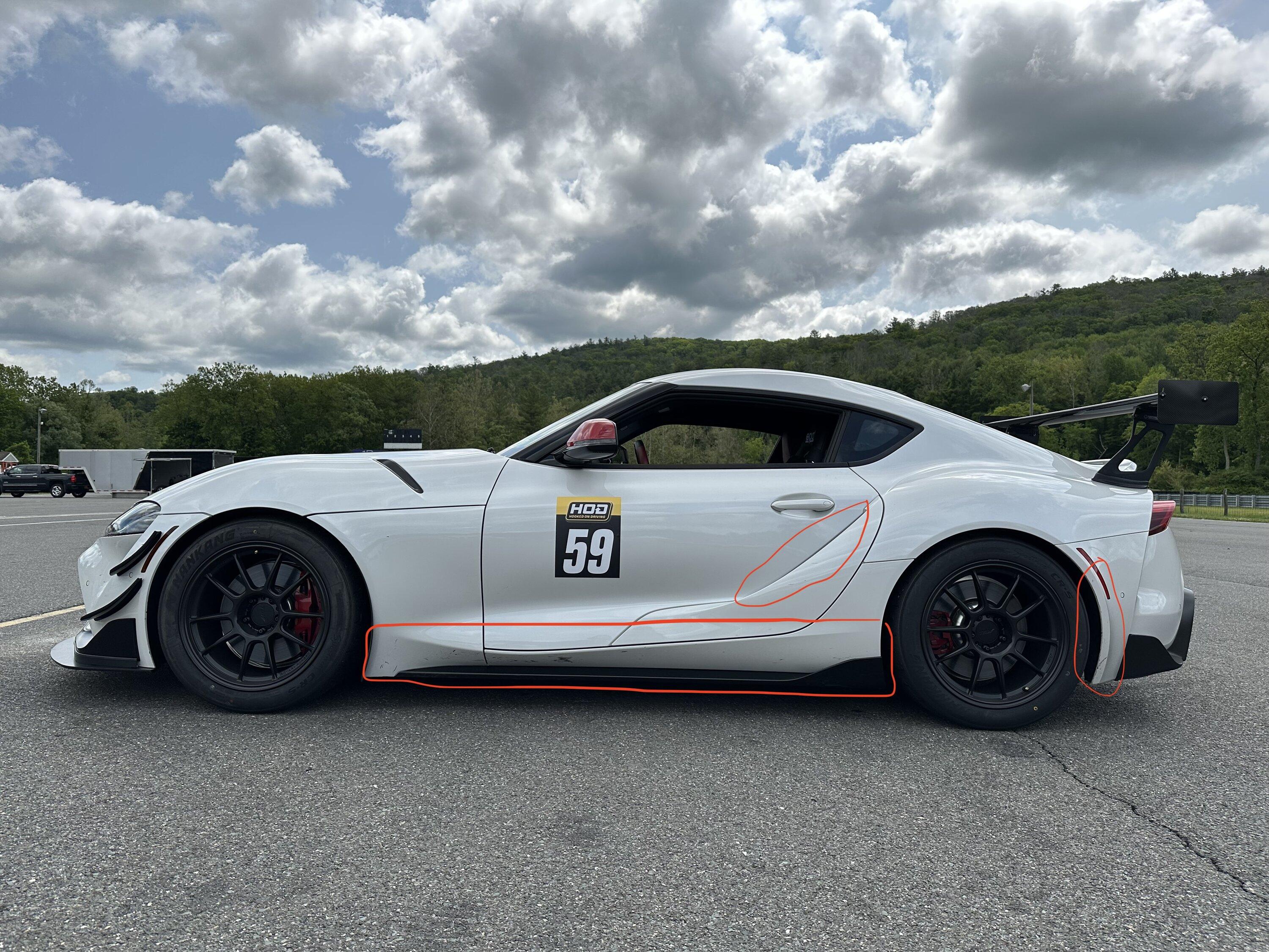

Yeah. My PPF guy actually said that if I'm doing track work I should get the sides done. I'm just protecting my car from Soccer Mum's and truck drivers. ?
These are the parts that get annihilated on my car from the track, I even have front rock guards.

This is why I've been considering keeping this wrap on for longer than I want. For the "protection" of random pieces of rubber. I know PPF will be more better, but this was free.99

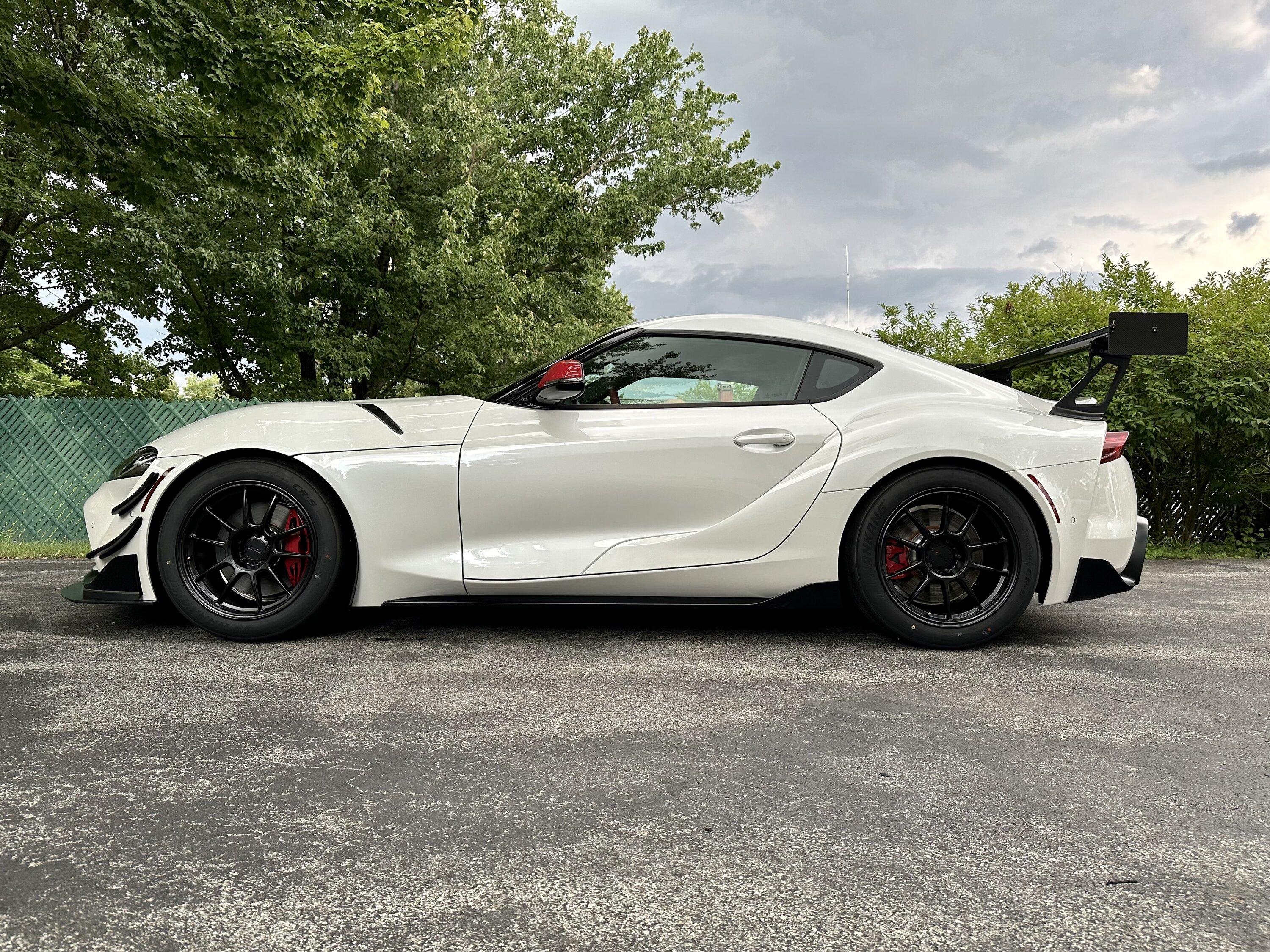

The rubber comes off. It's the sandblasting that doesn't. Here is the car weeks later:

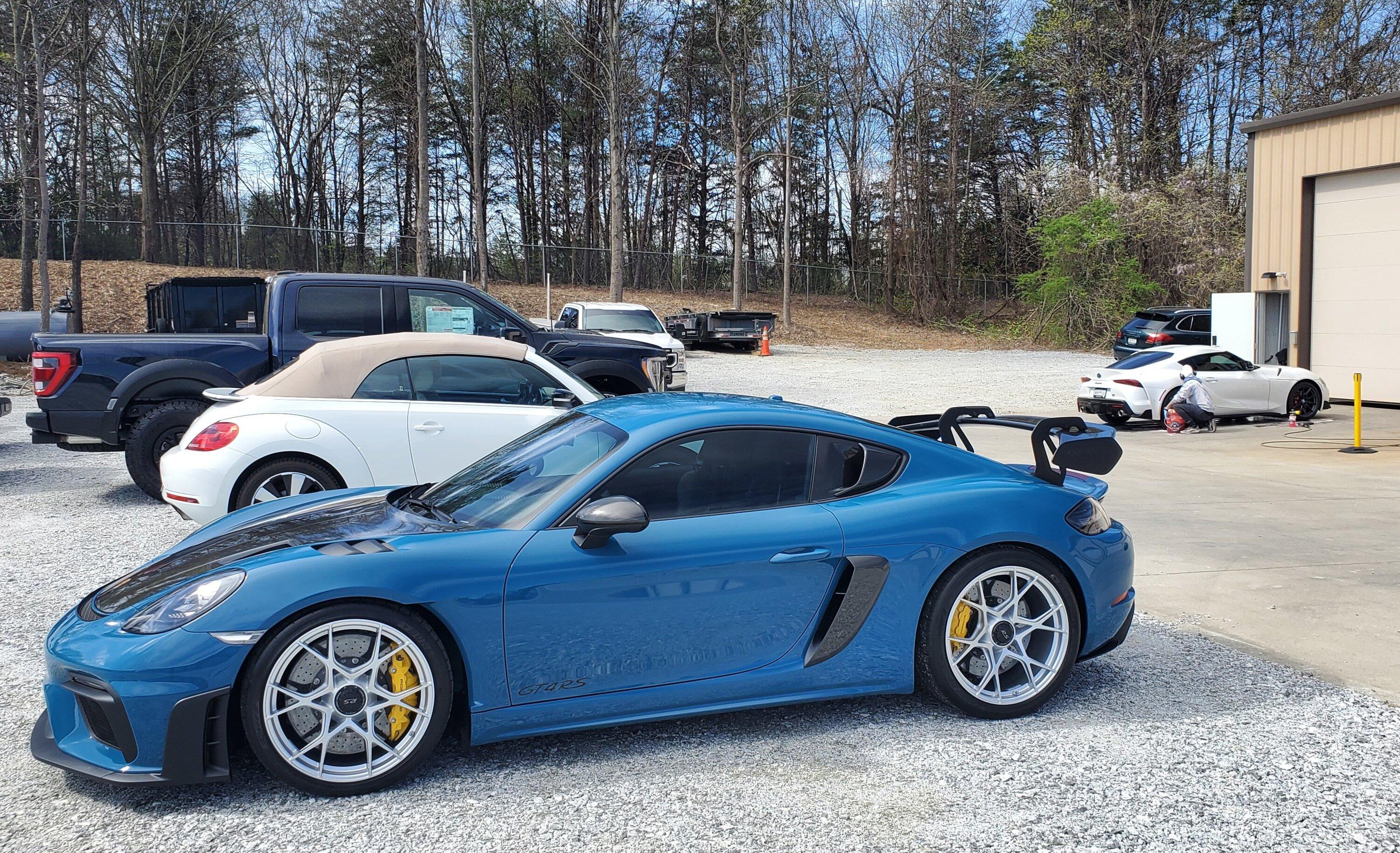

Yeah, my PPF installer said the Supra hood was one of the hardest cars he's done. That and a Porsche Macan hood apparently. This dude PPFs exotics on the regular too.... GT4RS was next in line after mine.
