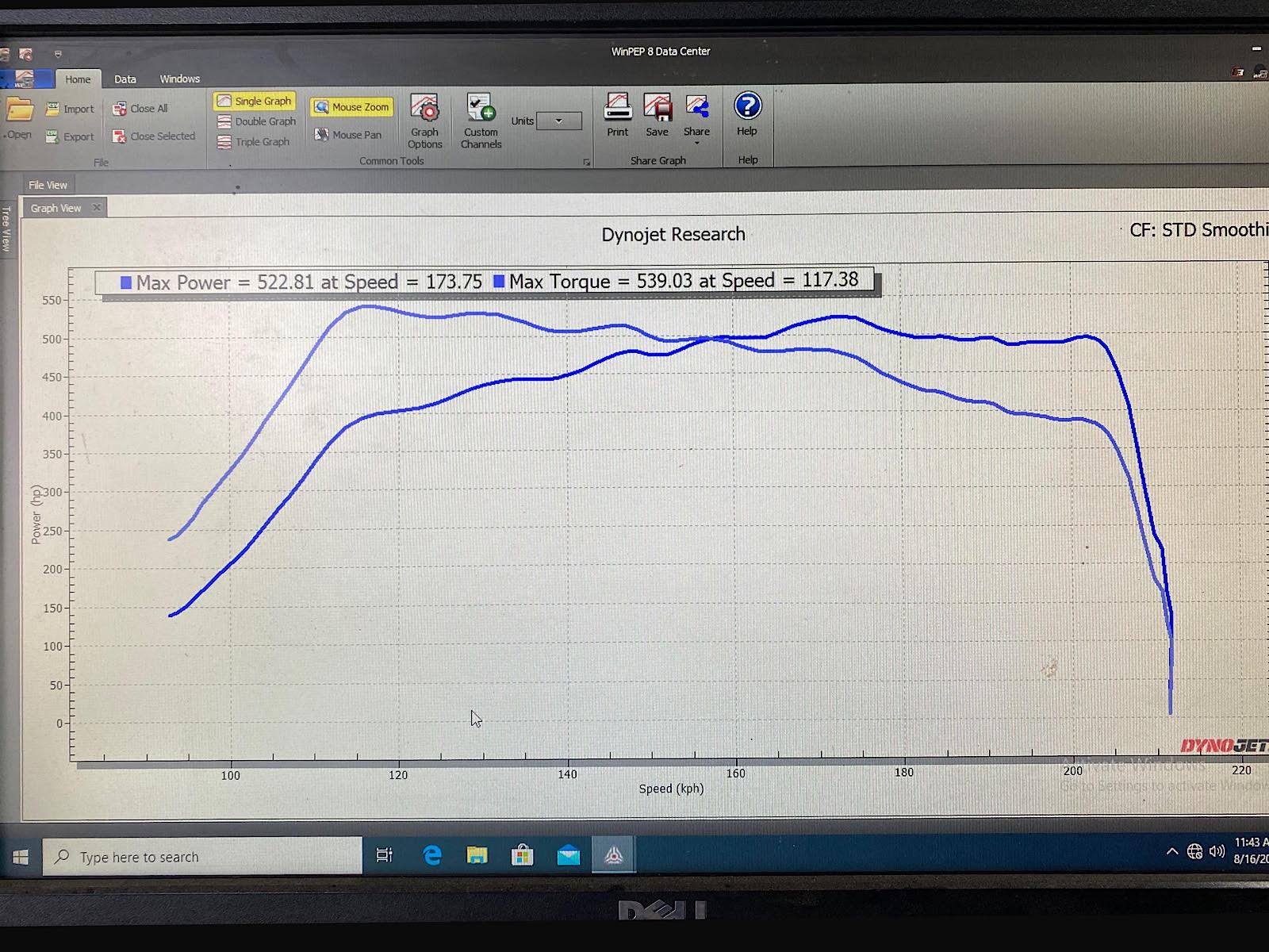

Dyno I made a few weeks back..
522whp 539wtq
Pure800 93 pump gas + 50/50 water meth for cooling + ECUTEK by Payn
Should receive a new improved map with latest Racerom
Jeff Payn made 566whp 585wtq running a Pure700 91 octane only on said updated map
Turbo has been absolutely great so far

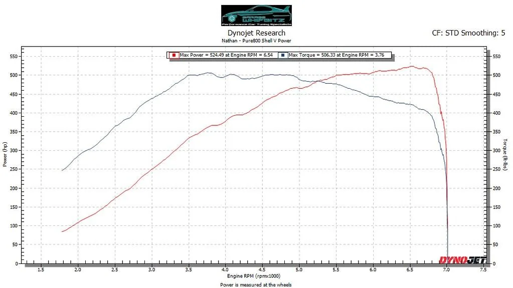

This is my dyno with Pure 800, downpipe, catless exhaust system. 99 RON fuel here in the UK, so equal to 93-95 octane US.
Tuned with ecutek.
