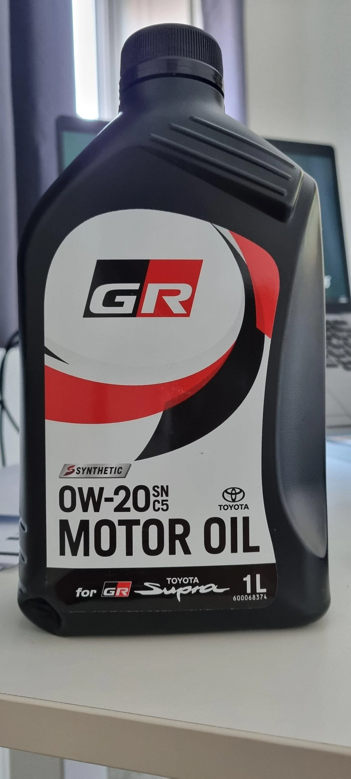

Does anyone know who makes the Toyota Supra oil (OW-20 SN C5)?
Do you know where I can buy it from? (I am in Europe).

What motor do you have? Assume its the 3.0..........get BMW oil. Its a BMW engine. If you are in Europe there is good oil to choose for it. Im in Germany. See your owners manual. 0W-30 in a good/current BMW spec will be fine.

it's probably an oil made specifically for north US/canadian customers. i believe it's made by exxonmobil.
if you want gr supra certified toyota oil, then you should visit your local toyota dealership instead.

BMW long life 17 fuel economy aka LL17FE is the oil rating you are looking for. I would say that LL01 and LL04 BMW oil specifications are probably more ideal than the 17FE but some people want better fuel economy and more engine wear.
