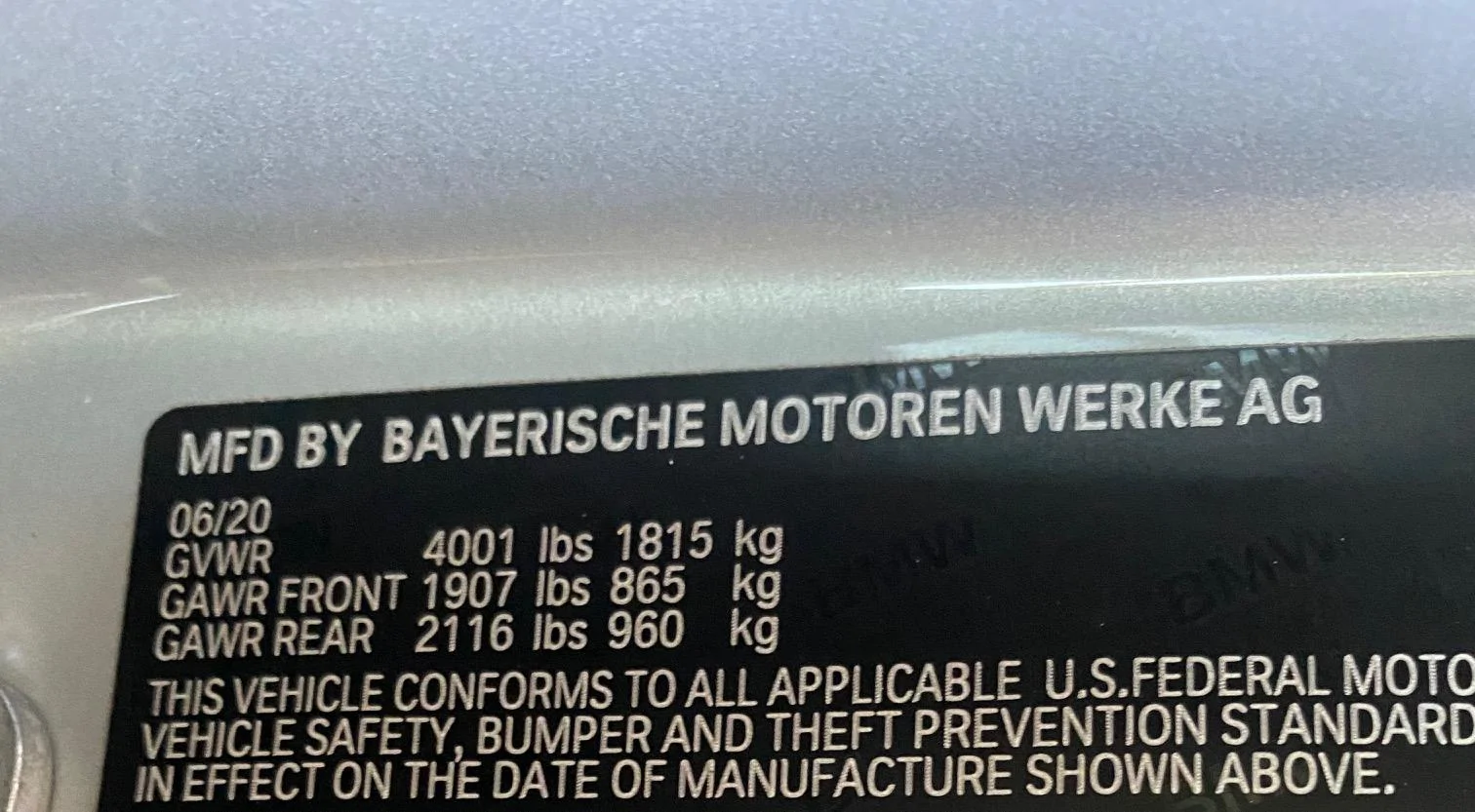

7/2020 and on have the new processor and security. Just look at the build dates on your door jamb, and that will tell you.

Any way to know whether or not my 2021 ecu can be unlocked or is the only way to send it to @Marshall@ViscontiTuning ? I’m not quite ready to tune but def would like to know moving forward
Some people claim a specific build date. Before making any large purchase, id certainly check the Cal ID first. This can be done with any ecutek module. No need to send in the ECU to check.
