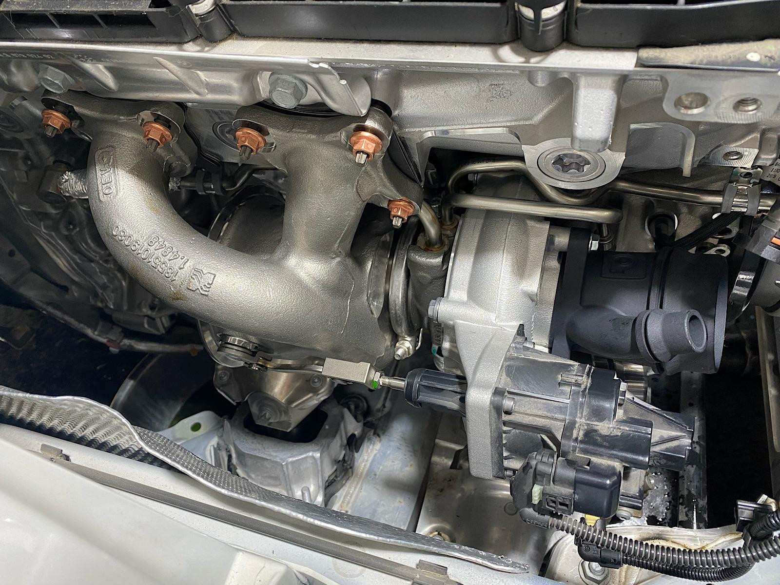

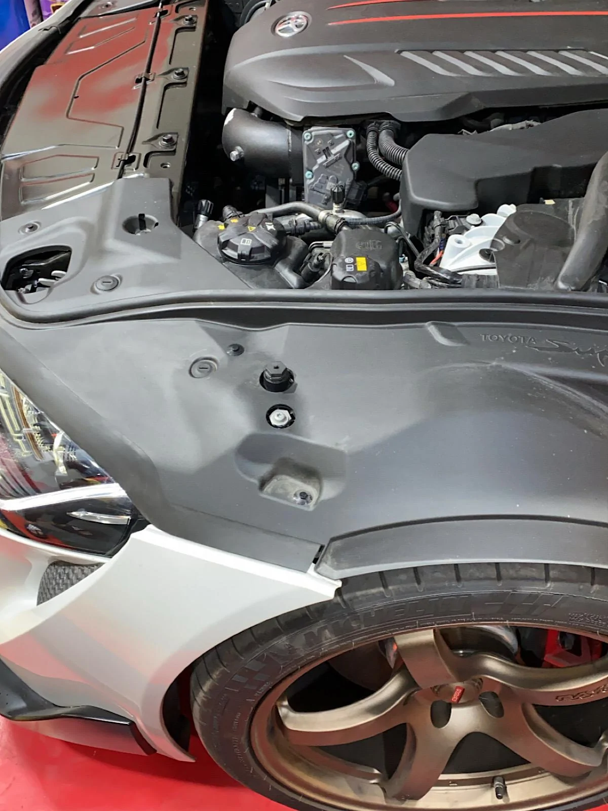

Had my Ecutek laying around for a month or so waiting for more car parts..
Installed a Pure turbo upgrade recently and went through the tuning process with Speedindustry and @Paynful Jeff Payn . More complicated than BM3 at first but then you get the hang of it and all seems very easy esp data logging
Car power mods are: Catted DP, exhaust, intake and Charge pipes
Extreme weather here 70C IAT's so I asked for a very conservative 91 octane tune. Did a total of around 7 data logs and 4 map revisions till now. Car is running perfect with stock like smoothness, runs through gears like stock (No early up shift and lugging on auto like BM3 before), no drive train malfunctions or CEL of any sort. and pulls really hard all the way to red line. More lag due to the bigger turbo but kind of makes it more fun in a way due to the instant power after it spools, reminds me of a 997 Porsche Turbo
Will do some dyno runs next week in a closed air conditioned garage (28C temp) alongside mixing it with MS109 in the end just to compare numbers
Tuner @Paynful has exceeded my expectations in terms of communication (I live in Kuwait), insight, being very informative and also dedicated with excitement that puts a smile on your face
