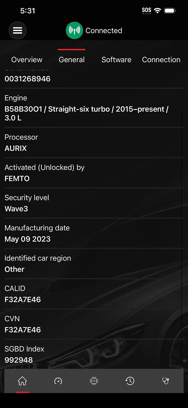

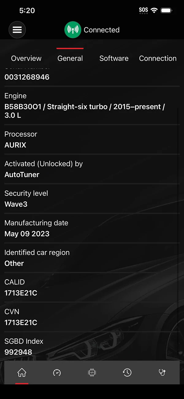

8,615
16,896
Most posts I have seen here and facebook is that people are having to go to the dealer and get the whole car flashed back to stock so the checksum in the DME matches what Toyota provides to the California SMOG board.....
It's the CVN mismatch that will kill you. That is what CA and MA currently check.
I know for a fact MHD does not spoof the CVN as I have done a before/after check.
Before/after flash:
Keen eyes will also notice the unlock value changes too. hahah. Originally Autotuner unlock and when flashed by MHD it now thinks it's a FEMTO unlock. ;)
