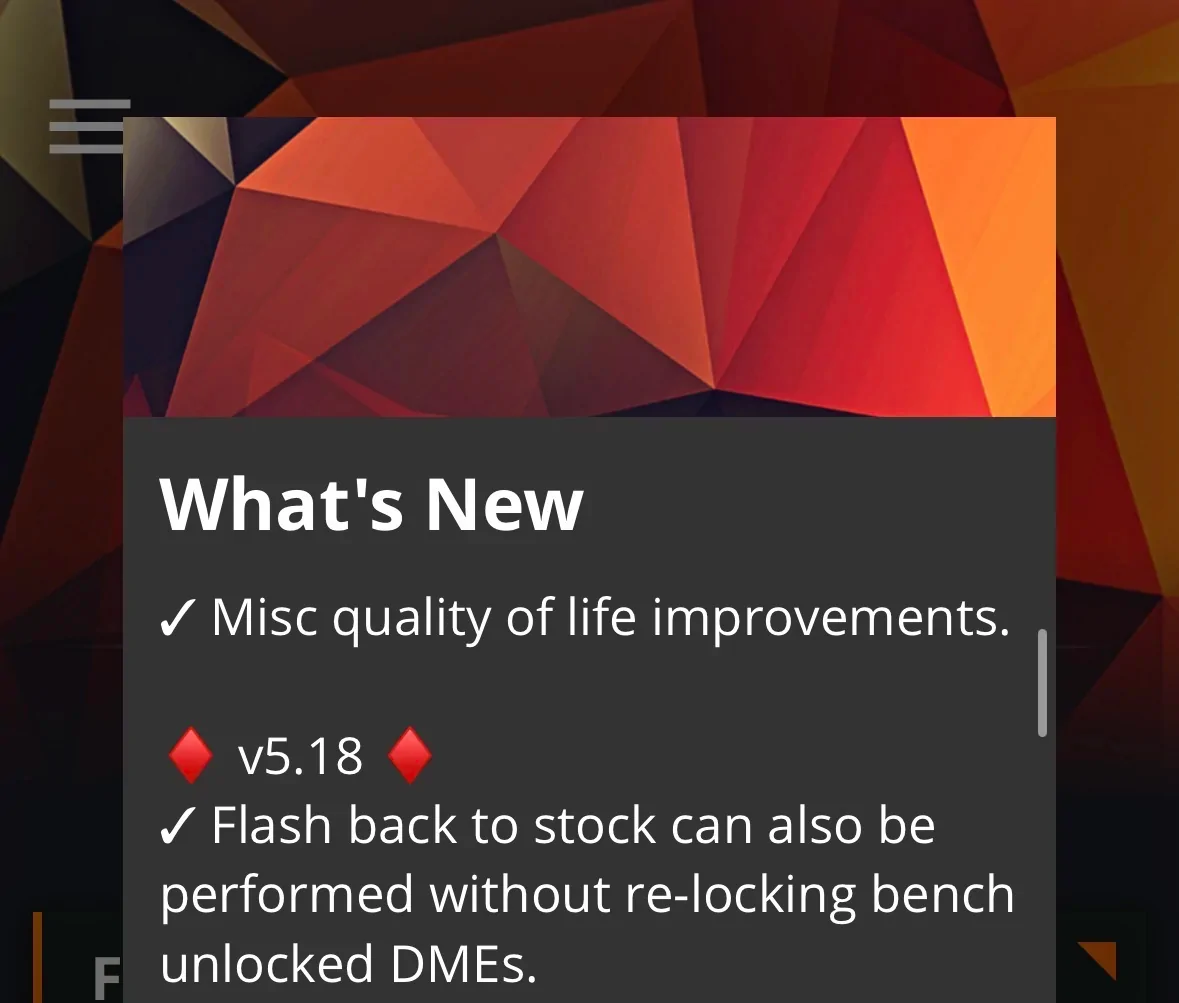

If you use the “flash back to stock” option on MHD, does it restore the Cal ID and CVN to OEM?
An update to MHD claims no need to bench unlock after flashing back to stock
I haven't tried it yet.

I was told by both AT and Femto that this would in fact bring it back to OE spec checksum, CID, CVN, etc. But with their new unlock, you can still unlock it afterwards so that's a good thing for Cali people or anyone dealing with Smog. Can't confirm it tho, someone wanna try for us? :)

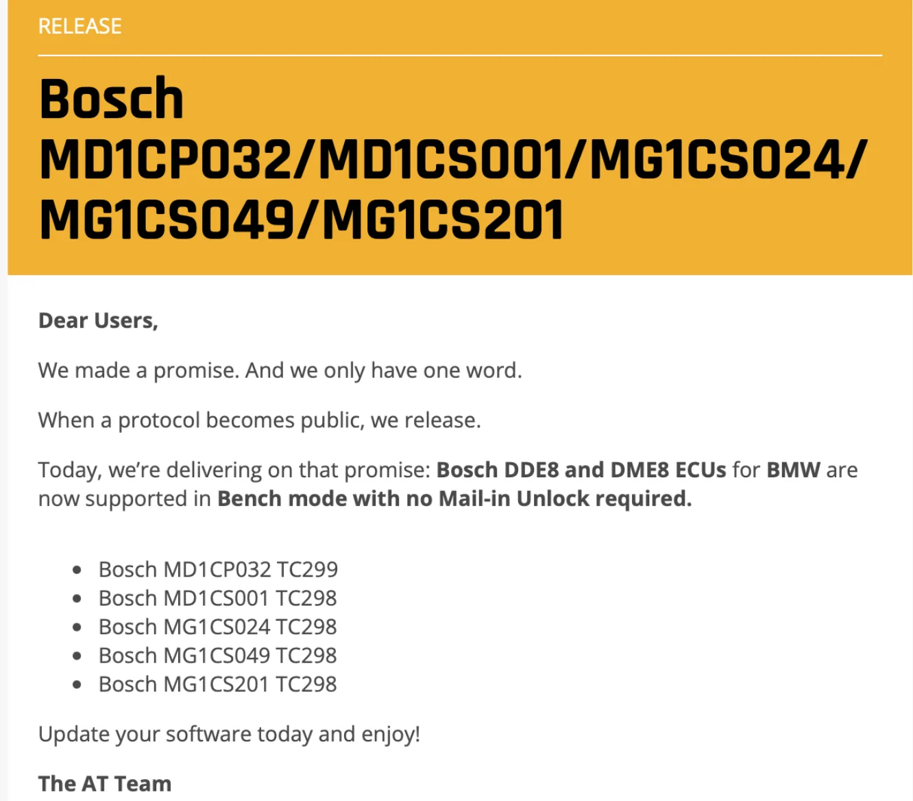

Seems like DME can now be bench unlocked now with no need to mail in. Lots of news coming out.

I don't live near Kies, Femto, or Autotuner. I can just go to an authorized dealer instead for a bench unlocked without having my DME opened. This is new to me.
Yes, it is new, just announced. Anyone with an AutoTuner tool can now bench unlock.
