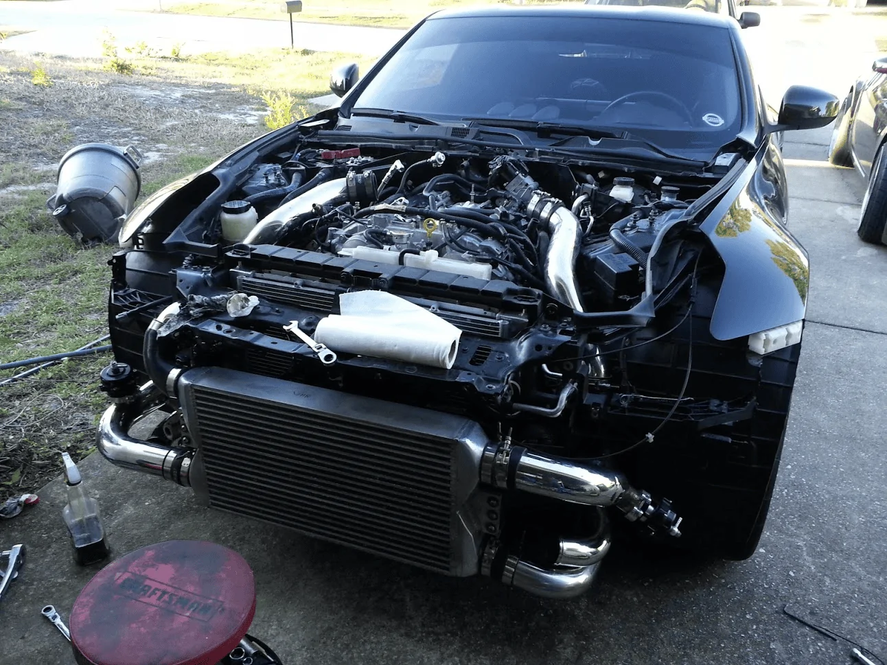

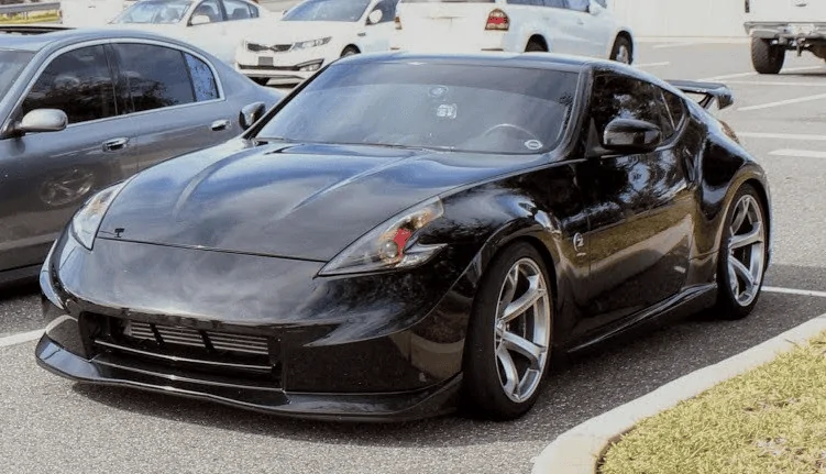

I previously had a GTM stg 2 twin turbo 370Z Nismo.
Car had all the standard issues the Zs have, but with much worse fuel starvation, heat management issues, increased difficulty of any work, serious diminishing returns on upgrades, and not being able to put down all the power as effectively as you'd want to.
1st - boosting your NA car. You need to make sure your motor is healthy enough for it, and second you want to make sure you have all the ancillary components up to snuff as well. Some of those just don't have a lot of options available for upgrading or if options do exist they cost so damn much because no one else does it. (i.e. transmission)
2nd - choose your turbo kit wisely, I've installed a few and they're not all created equally. Some of them had huge design flaws that the turbo was always destined to overboost.
3rd - The car isn't designed for it from the factory(and even in the case of the new Z), it is cramped in that engine bay. Working on things is a nightmare, and if you can't do it yourself, you better believe someone will charge you to have to deal with that nightmare.
Inline 6 vs V6 with turbos added after the fact... I cannot possibly emphasize how much easier upgrades are on the Supra.
TLDR: The aftermarket support and parts available for the Supra are so much greater in just two years than the support for the 370Z after a decade. The Supra takes to mods so much easier than the 370Z does and it is so well behaved with those modifications compared to the Z.
The cost to make my Supra as fast as my turbo 370Z, dp+tune so less than 2k
Time it took to install, less than an hour?
Vs cost on the Z, turbo kit, clutch, radiator, tune, fuel, brakes... ~15k and easily a couple of days of labor and that was with me installing it myself and not paying someone else.

Good for you... if you haven't run into it, then you're not going fast enough. Hell the damn cars ran hot from the factory without a turbo. I'd run into fuel starve after only a few laps and would have to top off in between sessions. I'd also have to turn down the boost to keep temps in line for full sessions. That's what happens when hot air is trying to cool off your oil, intercooler, and radiator.
From what I heard, everyone else who has boosted their 370Z has said it was the best thing ever, because the car felt just like it is from factory but much faster, and I can totally agree with that statement. It doesn't feel wonky, or weird or otherwise not like the NA motor was not suppose to feel like. The VQ37 totally works well with boost, it is very well known attribute on this platform. So I am extremely surprised you are against it? I guess each to their own.
I'm not against it, it was fun and I enjoyed it for years. Just compared to the Supra the 370Z is just an old platform that doesn't handle the power anywhere near as well. As for 'factory' sorry, going with an OS Giken or other heavy duty aftermarket clutch to handle the power, coil-overs, etc the car doesn't drive like factory anymore.
There is endless options of boosting the Z, and tons of aftermarket support for every aspect of boosting the Z, so I am unsure why you made that statement that their isnt much options or support? And once again, why did you say no1 else does it? There is bloody bucket loads of people doing boost conversions on their Z. Buddy where are you getting your information from?
Endless options and a lot of them are designed poorly. As for why I made that statement, I've installed GTM, Fast Intentions, a BP single, and worked on a Stillen supercharged Z.
Twin-turbo kits require dropping the motor, and the clearances are a pain in the ass or you're paying someone to install it and do that work. The Stillen kit was hot garbage, and the BP single literally had the wastegate positioned in the classic diagram of where NOT to install a wastegate because it'd never be able to bleed enough exhaust gas out, and sure enough, the boost creep was bad.
As for why I said there's limited support? I haven't checked in a while, but half a decade into the Z34 and there weren't any transmission upgrades for the transmission itself available, that's what makes me say support is terrible. You want to toss on a turbo and run 8-10psi, sure you're good to go. You want to go much higher and what are your options on the transmission itself?
In the early days, it was basically HKS, GTM for the 370Z, or Stillen with their horrible supercharger. Fast Intentions came out later and their kit was decent and then a bunch of really terrible single turbo kits popped up.
Most kits on the market today are of high quality and had tons of upgrades and developments over the years, that they are very good in performance and reliability. I can't recall having any performance or reliability issues in the 10000 miles I have had my Z boosted besides one of the bolts on the wastegate acutators become threaded which was a $60 fix.
HAHAHAHAHAHAH
HAHAHAHAHAHA
'tons of upgrades and developments' read that again, you mean they didn't know how to design a kit properly, released a version and had customers test it out and then released up to v6 or whatever fixing their poor design, THAT's what I mean when I say I've seen some terrible turbo kits
Also, I daily drove and tracked mine for almost 50,000 hard boosted miles, so yeah... come back after you've actually driven that car a bit more and pushed it harder.
Or don't, I really don't care. But to act like because it didn't happen to you, then it must not happen to anyone is just naive. Sorry, I don't exactly put a ton of stock in your understanding of what makes a good turbo kit or 'high quality' based on your previous responses.
Like I said before, there are literally tons of people who have boosted their Z and made the statement it should have been boosted from factory because of how well the VQ37 responds to boost and well it handles it.
And? your point is lots of people did it and think its fast? I've had both... my Supra is way faster and barely touching its potential with so little effort compared to building the Z.
My mechanic had no trouble installing and modding my Z, and they never touched a 370Z before my car. I don't believe it would be a nightmare for any experienced mechanic at all, hell I know people are doing it in their bakcyard garages. Supra being easier to mod, maybe so, I don't personally know, but definitely cannot say the Z is a nightmare to upgrade when 100s are boosting theirs every year.
Again just because lots of people are doing something doesn't mean it isn't a pain to do it.
Again, I am a very experienced mechanic especially on boosted Z's and I have installed several kits on my back and on a lift, no issue doing it. It's just a pain in the ass that if I'm not doing it for myself I'm damn sure charing you a lot of money to do. Look at the pic I posted again, or look at your own kit... look at all that piping, then look at where the turbos are when you have to service anything on them. Then go watch a youtube video of someone upgrading the turbo in the Supra.
Yes well I guess I can agree with your statement that it costs less to make the Supra as fast or faster, but then we are talking about are more modern and advanced engine, and also another higher end market with the Supra. The supra in my country is 2x the price of the Z, or atleast 1.5x as expensive as when the Z first came out here.
1.5X as expensive as the Z, but then what about The Z + all the upgrades is the point, especially for you if you're not doing any of the work yourself and paying labor. At the end of the day, the price isn't that different and the Supra is a far better vehicle with far more potential.
TLDR: Just because a 'shop' sells something doesn't mean its 'quality', just because you don't know about it or it didn't happen to you, doesn't mean it doesn't happen, and just because everyone is doing something doesn't automatically make it a good idea or preclude it from still being a lot of work
