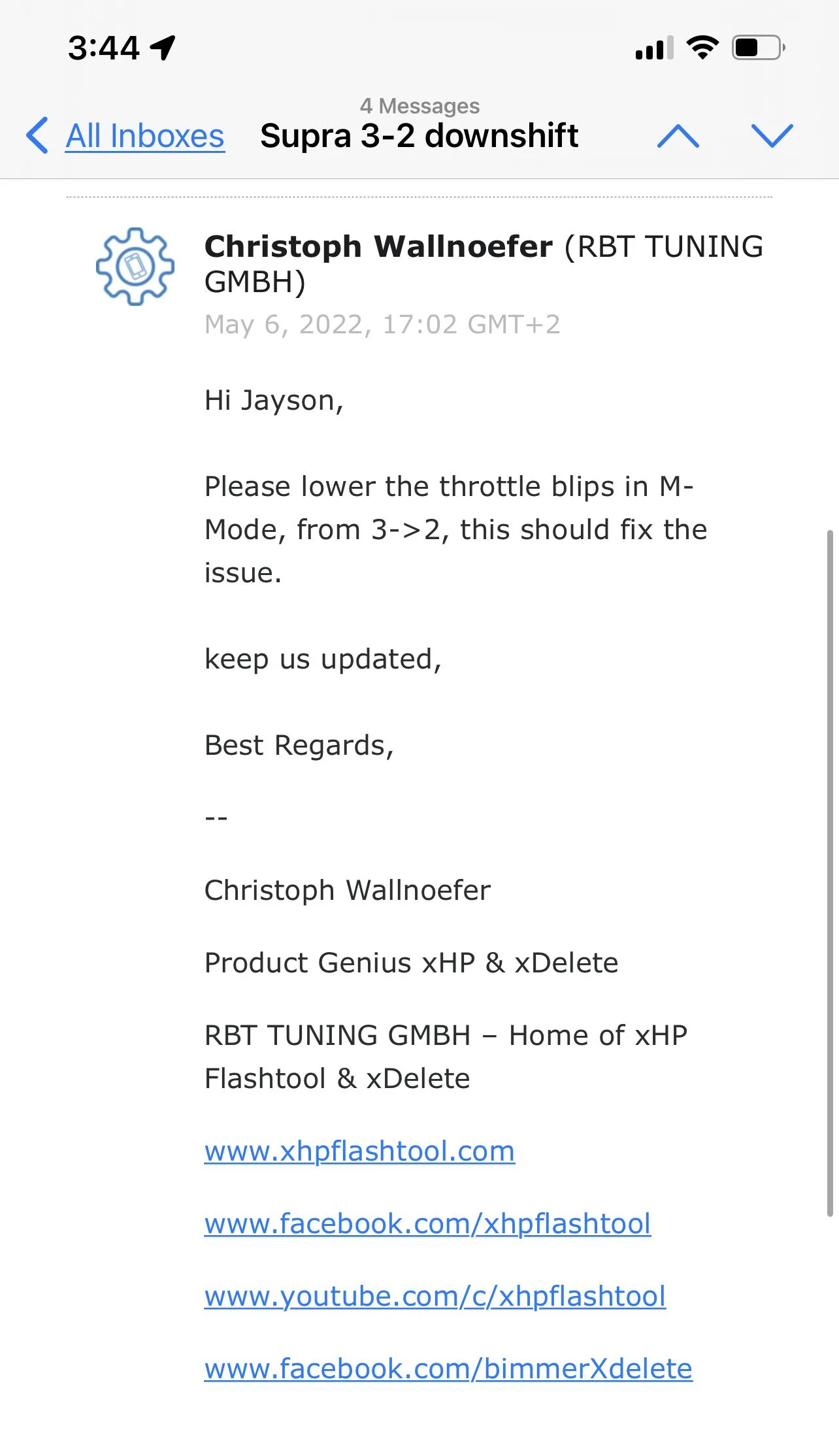

i went with -15%
Ah so this confirms my earlier thoughts. M mode blips actually affect the car in other modes as well. I have had this around -5% but will dip it a bit lower. Shame cause it actually really pops in second when it does blip properly.
As for the other gears I have these blips cranked and most of them are comfrotable enough.

I was having the same issue on the 3-2 downshift, here’s what did the trick for me after contacting Xhp, btw they replied back really fast so their support people is doing their job!
i went with -15%
Thanks for this information. -15% on 3-2 blips solved the issues.
