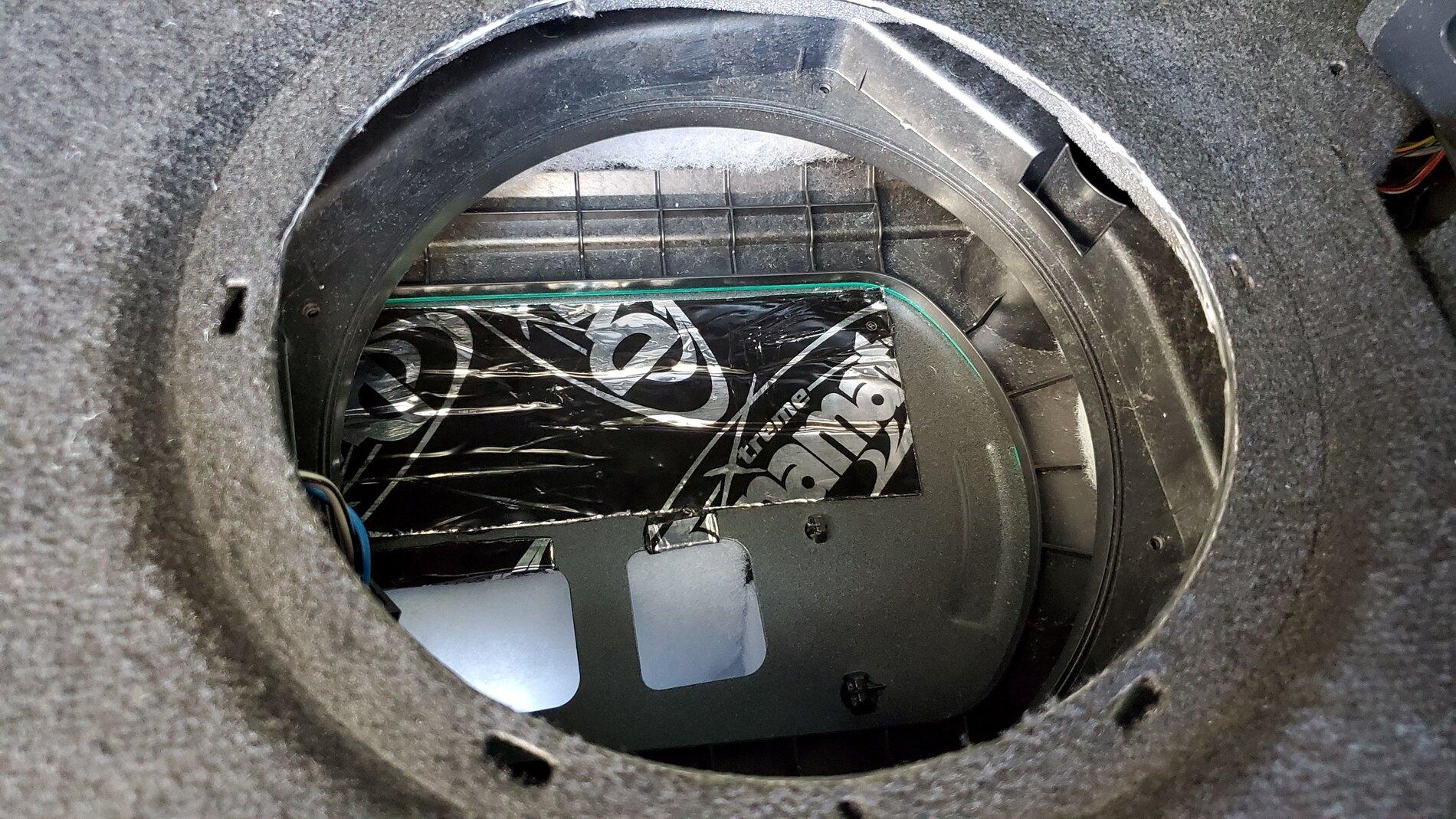

Here is a pic with woofer removed to give you an idea as to what it would still take in install wadding from the top (under the woofer)
TBH this should be in the main post. I think it would clear up everyones questions about the wadding insertion without removing the enclosure box. Took me 26 pages of reading to figure out how NOT to remove the sub enclosure and do the wadding. Cheers!
Edit: I ended up taking the side panels out and lifting the enclosure to remove the subs. PITA and broke a few tabs in the process. Probably not worth doing but I did get the wadding in the holes as cut out and shoved in

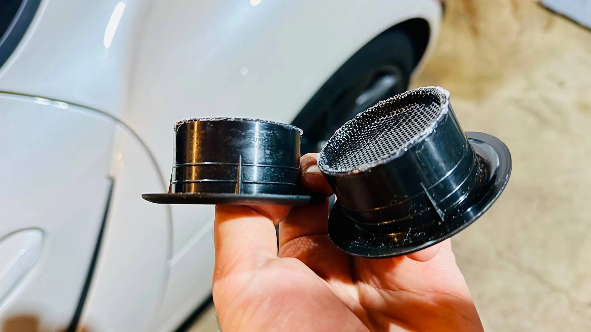

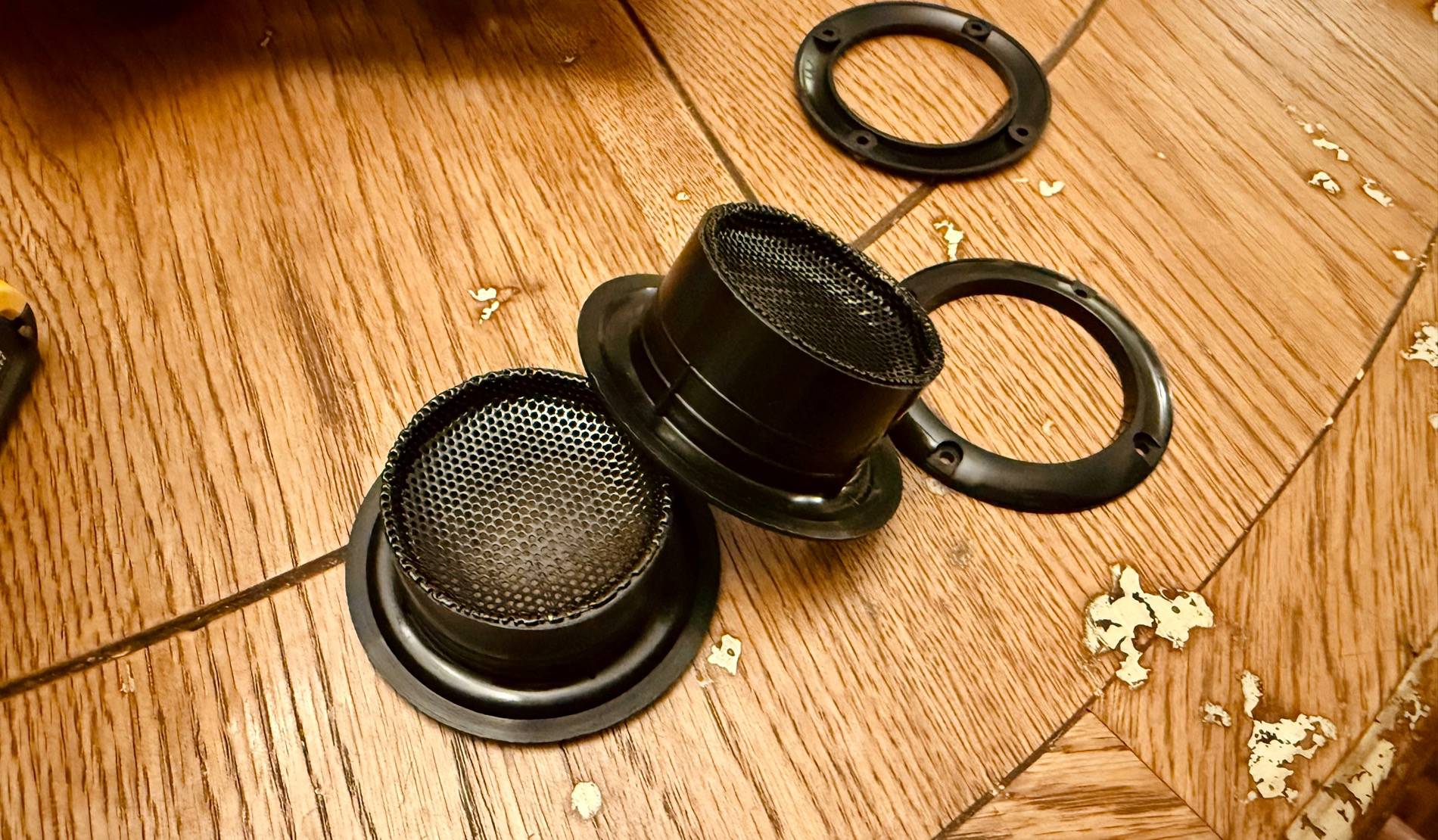

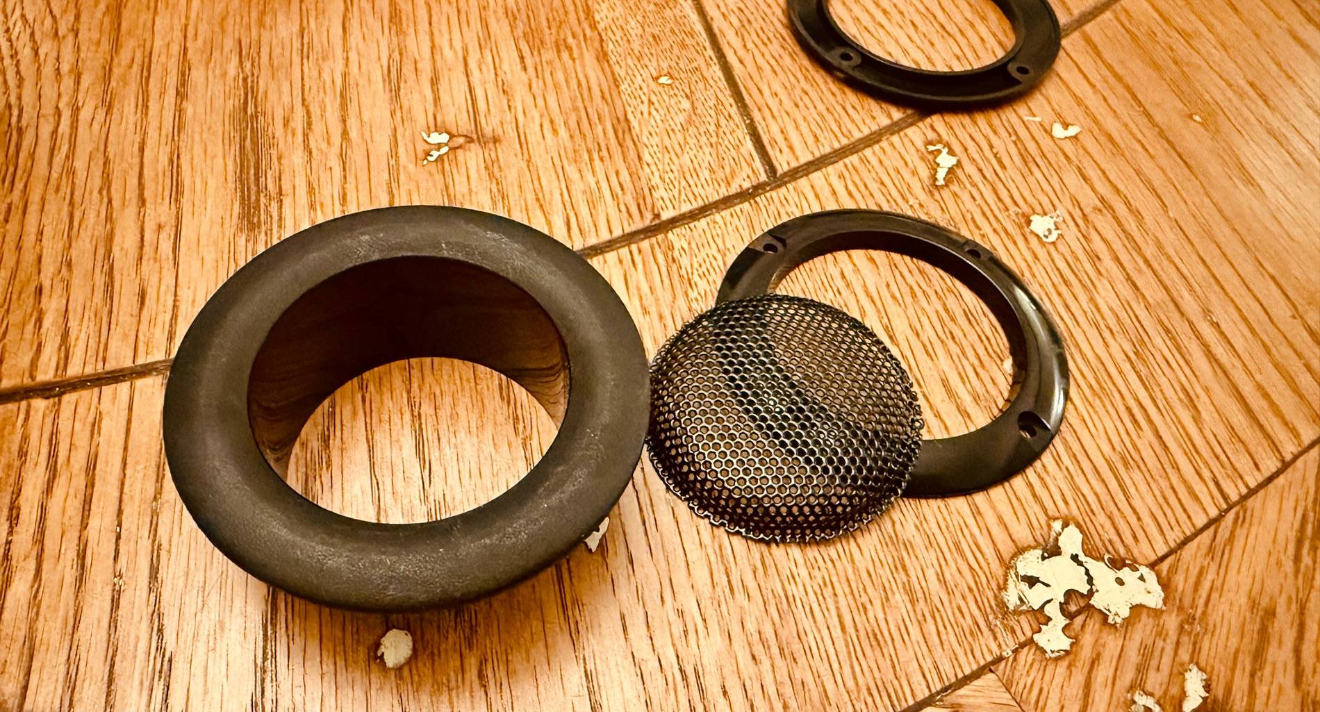

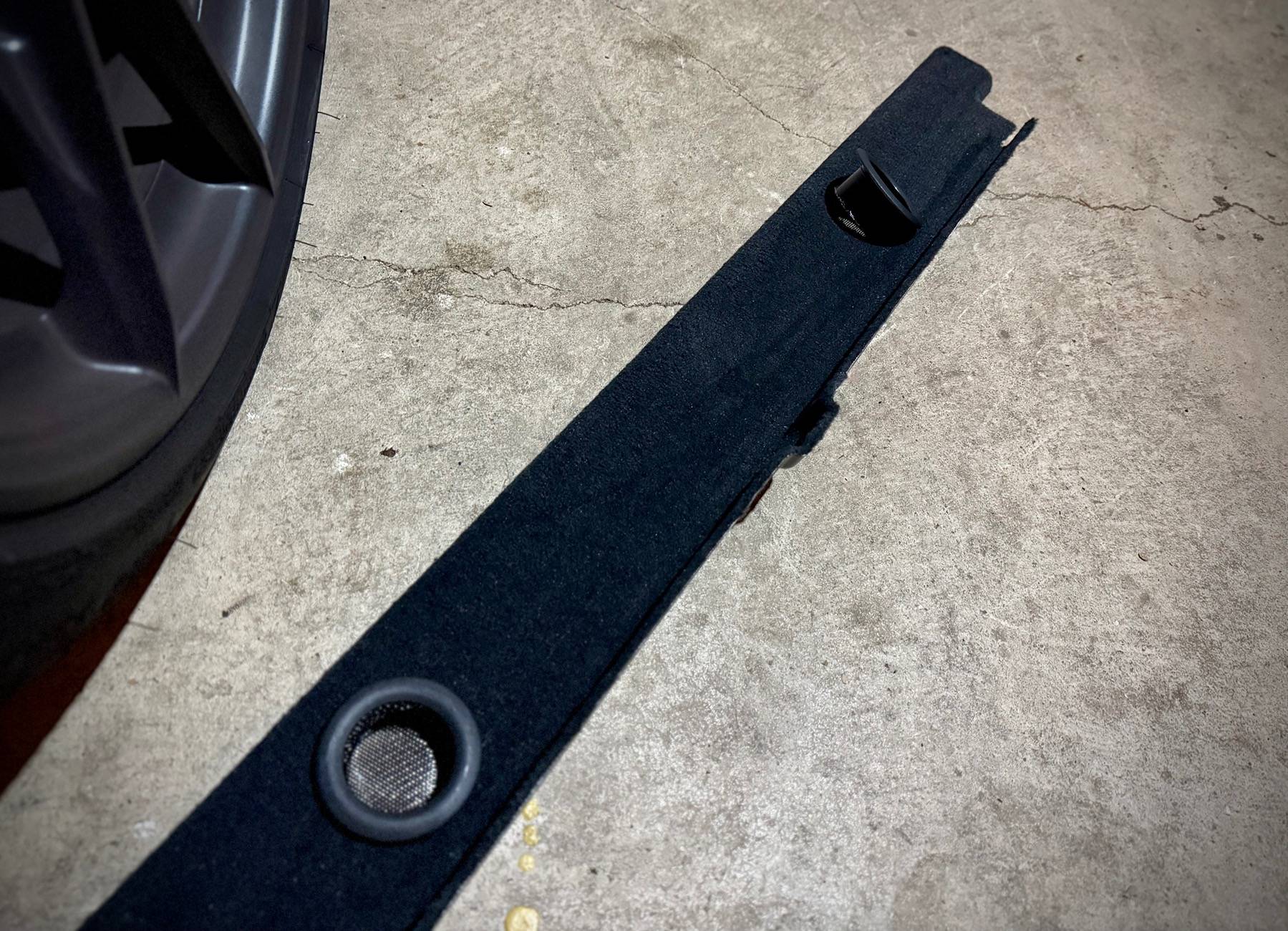

Just completed the Tadda Port Mod. I got everything from Amazon in one delivery, and wanted to share reference links to help anyone in the USA thinking about doing this.
Some links are redundant with the first post, but listing everything for completeness.

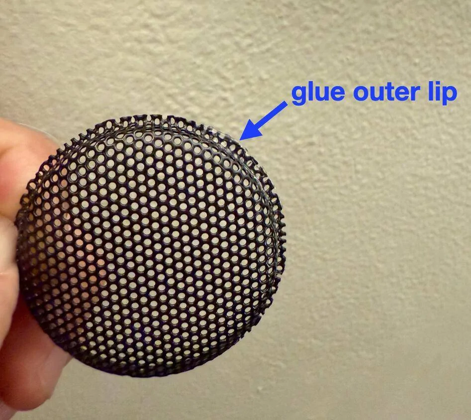

These Grill Cover Mesh come disassembled and fit perfectly with the back of the Speaker Port Tube.
The grill's outer liner and screws are NOT used. Just keep the mesh.
These literally just pop on the back perfectly.
Apply a very thin layer of Hot Glue or Super Glue around the mesh's outer lip, then press the mesh down on to the back of the ABS Speaker Port.
I used a Hot Glue gun.
Flush fit.
Pop them in, glue, and you're done.
