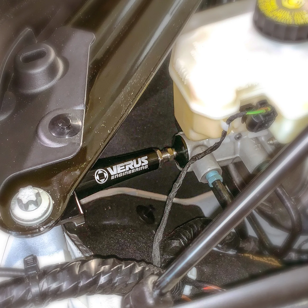

I'll chime in after just installing the Torque Solutions brace. I went with it because it was about $20 cheaper than Verus' model. It was nice that it came pre-assembled and uses a single bolt vs. a 3-bolt setup that you have to self assemble the two pieces. My concern was once it was bolted in loosely, if I pushed the brace back fully against the strut tower, the angle of the brace was nowhere near pointed to the center of the master cylinder. I had to push it inward, therefor losing the outside support. I'm going to assume the deflection pressure from the master cylinder can't push the brace with two bolts torqued at the factory spec. Not sure if the Verus model has a similar issue, but I'd be curious if it is designed at a more appropriate angle.

So this week I've installed the Verus brace. But doing so, it got me thinking.
Won't the brace be more detrimental than beneficial to the master cylinder? Let me elaborate.
The brace is mounted on the front strut supension, and the chassis has flex in it. So... As much as the brake master cylinder pushes to the brace, and the strut. The strut can also push back to the master cylinder....
Maybe with some kind of impact on the front wheel can the master cylinder crack or take damage?
Personally I would't be worrying too much about that aspect of the brace. It looks impressive watching the dial gauge movement reduction with the brace but we also have no idea of whether or not the pedal pressure was the same in the before and after test. For a road car with road driving pedal pressures I doubt it's worth the effort of fitting. I don't think pedal pressure would be high enough to make firewall flex a feel issue.

Installed the Verus brake master cylinder brace in early 2022. I got my car in 2021 lol
Were you able to tell the difference from street driving? The Verus video makes it seem like the firewall is as thin as a cheese slice.
-RJM
Yes I felt a difference on the track and also on the street. Brake pedal feel is firmer especially during hard braking. It's such a simple functional mod and easy to install.

I did not have clunking, but the brace made a discernible difference in pedal feel. Must-have mod for me. Wish I had done it sooner.

The pedal feel is discernibly firmer even for a road car. I'm not sold on every gadget from Verus Engineering but this one is a winner and is low hanging fruit as far as I'm concerned.

I went ahead and installed one. Normal driving you don’t feel a difference. When you get deeper into the pedal on heavier braking is when you notice the brace is there.
I’ve also noticed NVH being transferred from the strut tower. You can feel the slight vibration at your foot when the MBC force increases against the brace.
I guess everything has pros and cons.
