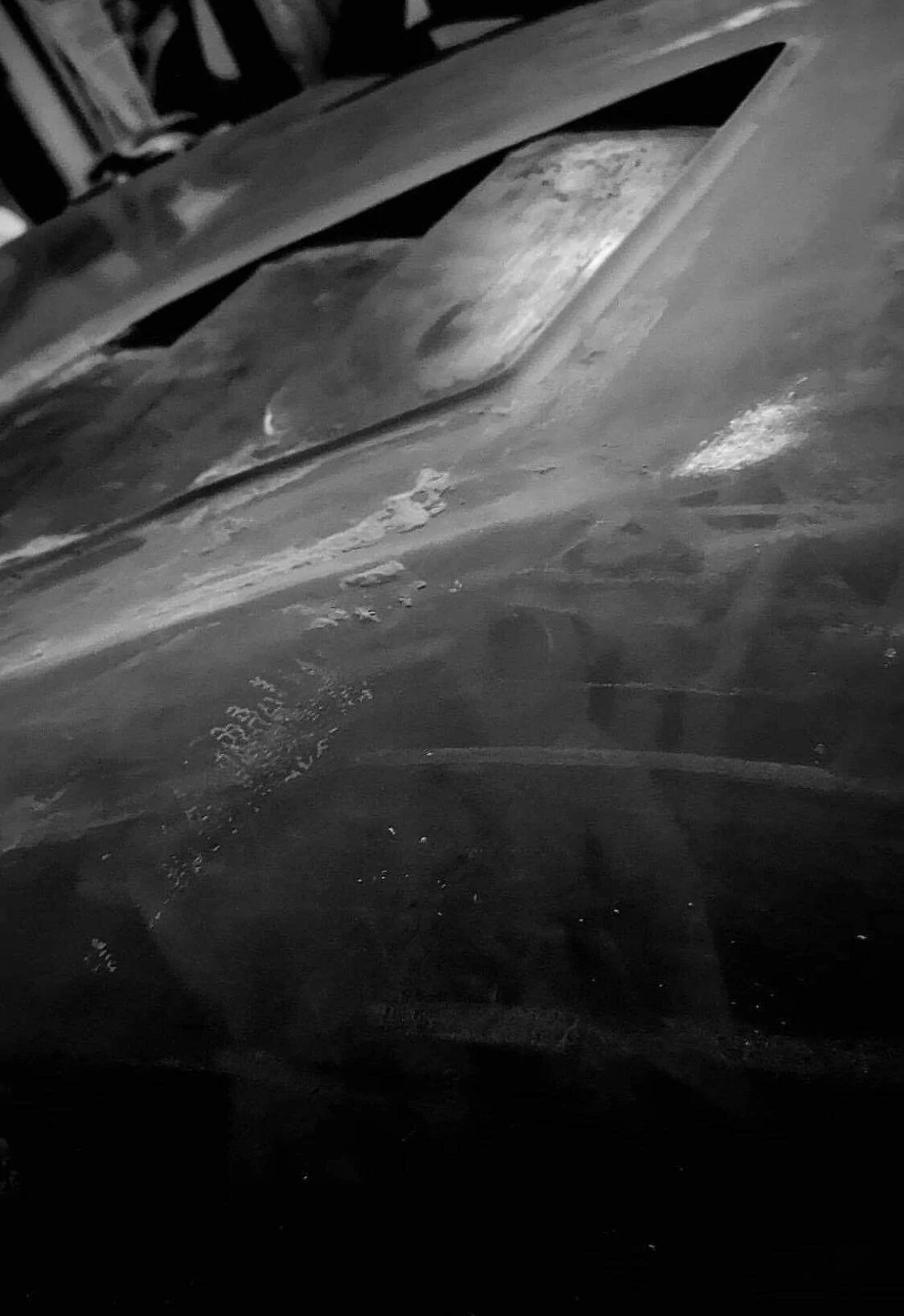

Mid-week update: I've been busy in school, but our aero master has been even busier. He hasn't even shown me how anything looks but did give me this teaser shot of the hood in progress... I MIGHT be a bit biased but sorry, TRD Who?

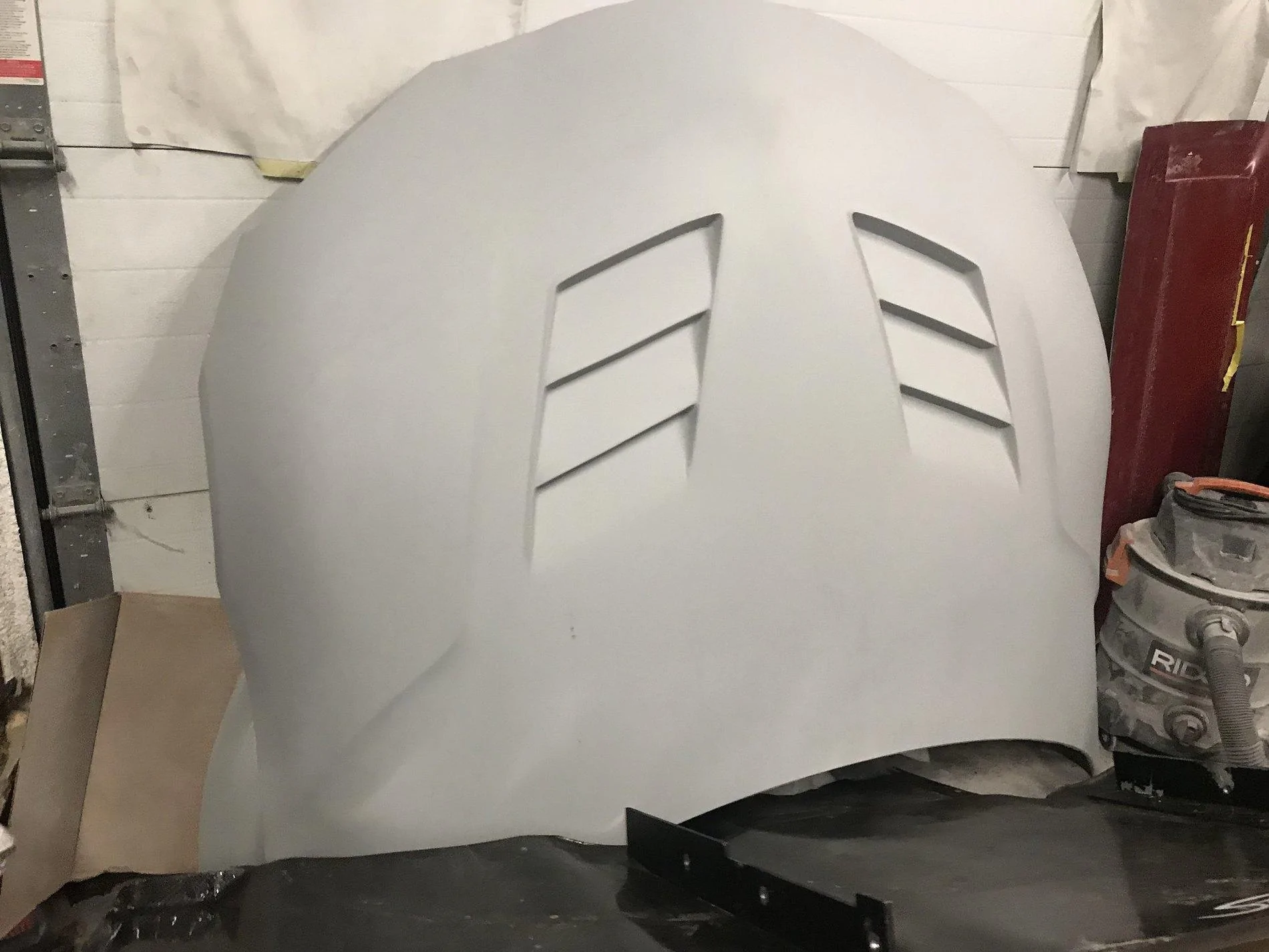

First off, here’s how our PhD Racing x Spage Sport hood will look! This is a work-in-progress, so the actual vents on the hood will be opened in the completed version. We will be able to offer this hood in fiberglass or dry carbon, with or without the main vents, and with or without the side fender vents (not finished yet). The unsightly OE fake vent is also deleted, but it can be retained if requested. The front lip, front splitter, and rear wing and more are all still in the works.

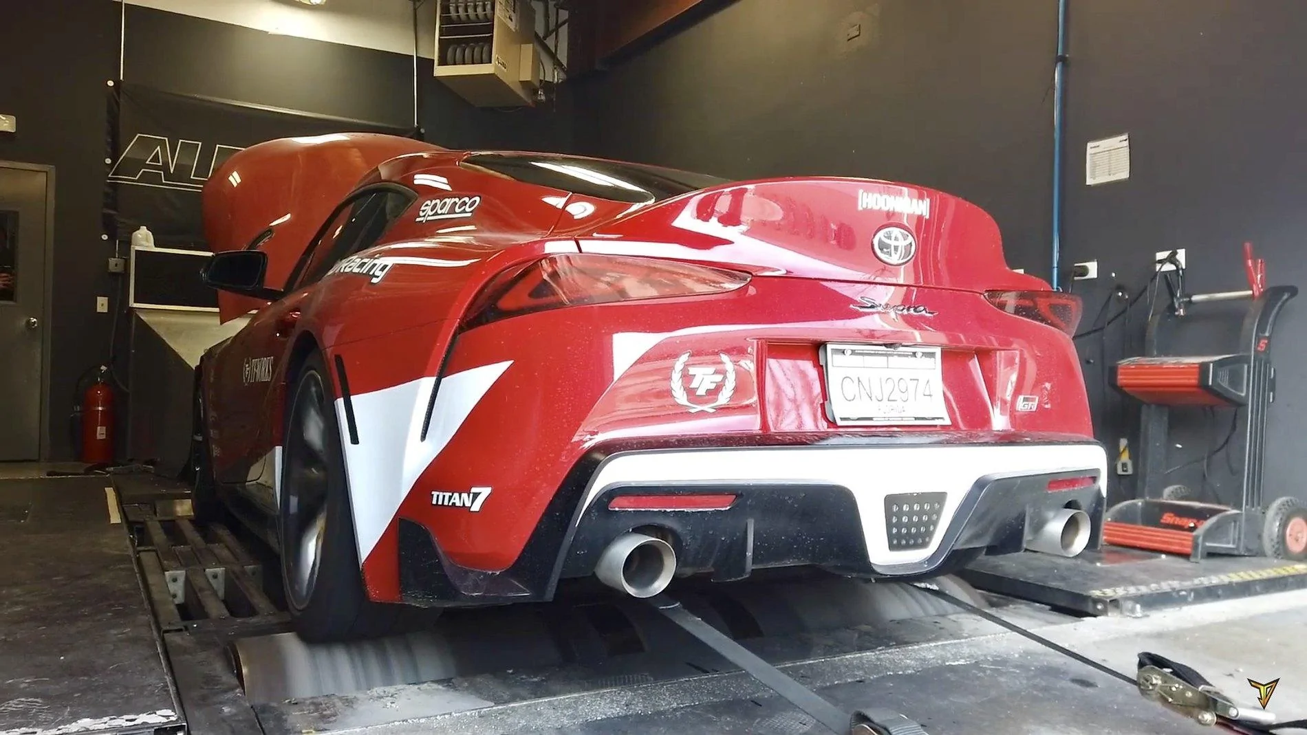

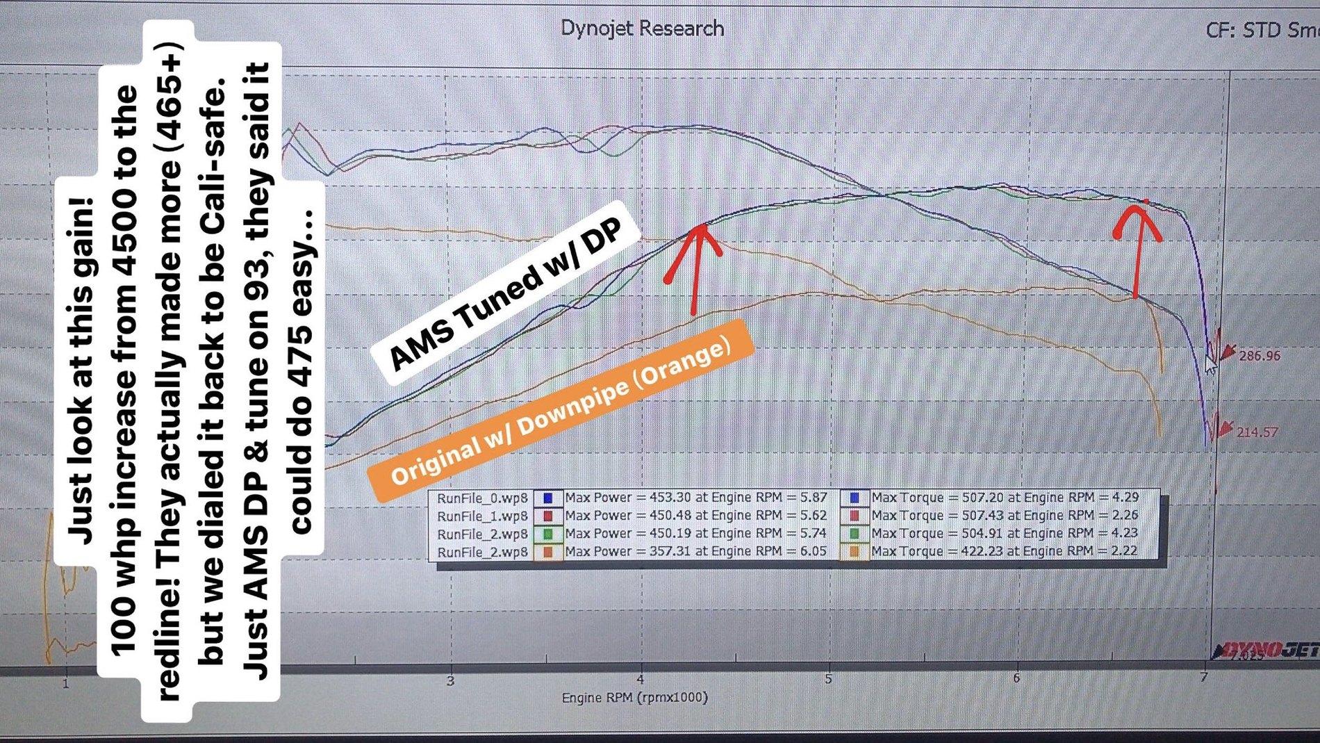

The car was then taken to AMS Performance, our powertrain partner, for their own AMS downpipe and tune. Unfortunately my Base was one of the many affected by the new Rom files and couldn’t be flashed through the OBD port, but the guys managed to bench flash it and we gained a solid 100 whp from 5k to 7500 rpm. This is actually a safe detune as we wanted to be safe for our first real event with the V2 car, and that we’re worried about the fuel quality in California where we’d be competing. According to the tuner, there is room for at least another 25 whp.

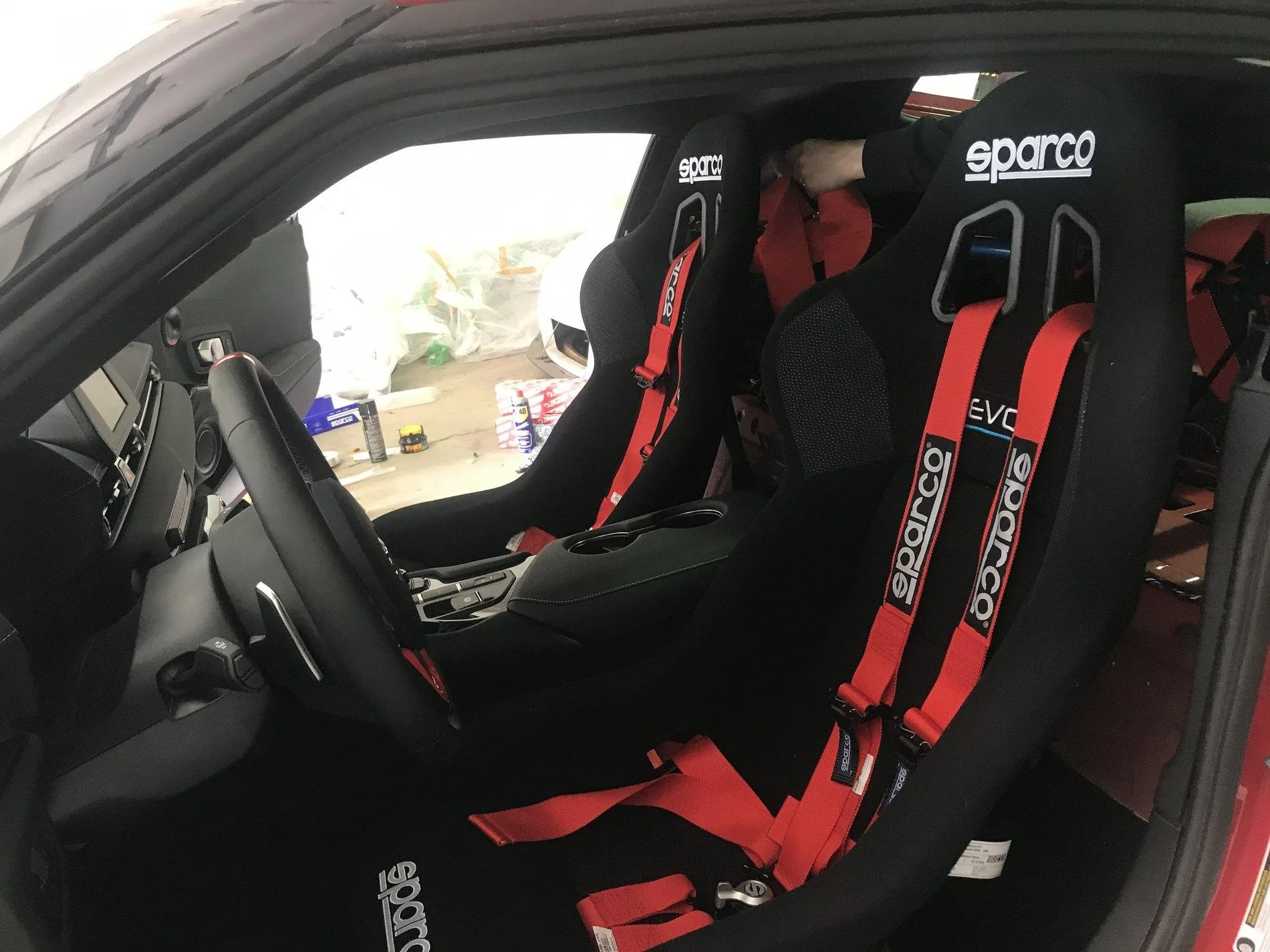

With the tune complete, we focused on the next step, weight reduction. We installed an Antigravity Group 47 30 Ah Lithium Ion battery, but it was a little too short to reach the side bracket, so we’ll have to custom fab something up. The rear trunk panels are once again removed, and we also received a shipment from our sponsor Sparco and installed a pair of their Evo QRT seats and 6 point harnesses. The seat is perfect for a slim-build driver and offers a lot of shoulder support but is very comfortable (at least for my 21 years old back). We didn’t have a scale, but we estimate that between the two seats, we saved about 60-65 lbs from the heavy OEM seats. A further 50 lbs from the battery and 50 lbs from the interior brings our weight reduction total to about 150-160 lbs, but we’ll put the car on the scales soon.
