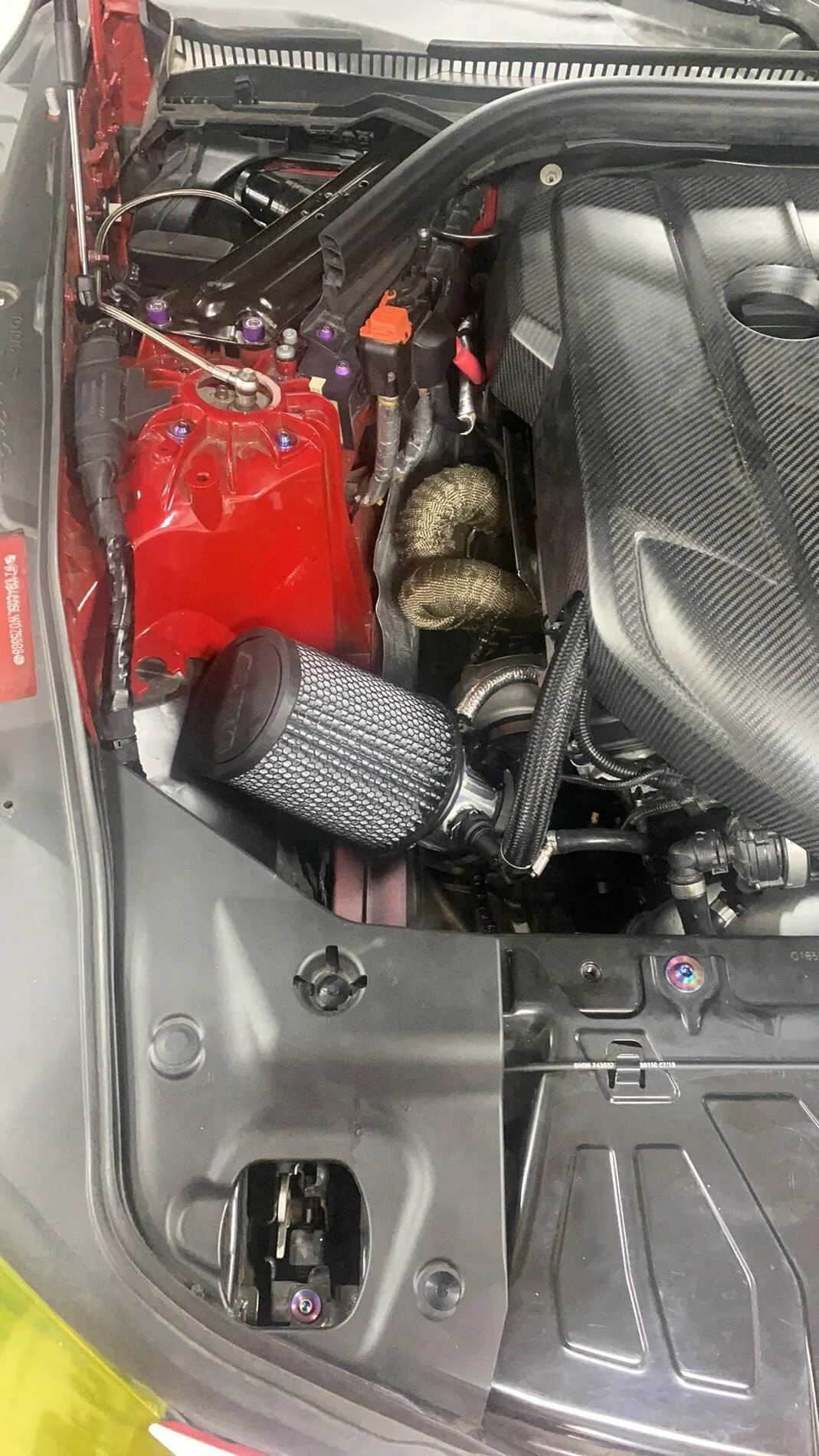

The AMS Tune on EcuTek beta software is getting close, and we made a reliable 460 whp and 530 tq on pump gas.
Neo Motorsport BBK was good, but we're working with Neo to make some changes to improve the performance and correct the bias a little better.
Biggest thing to note, we noticed a drop in power on a long run, and I'm suspecting the Intake air temp is getting through the roof. We'll work with AMS on something to combat this, but just remember the car is still on 100% stock cooling.
